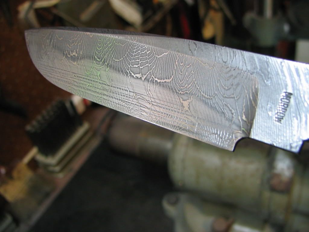

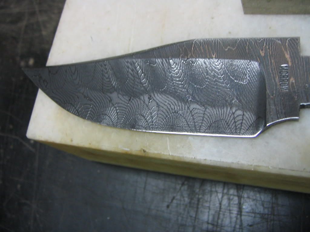

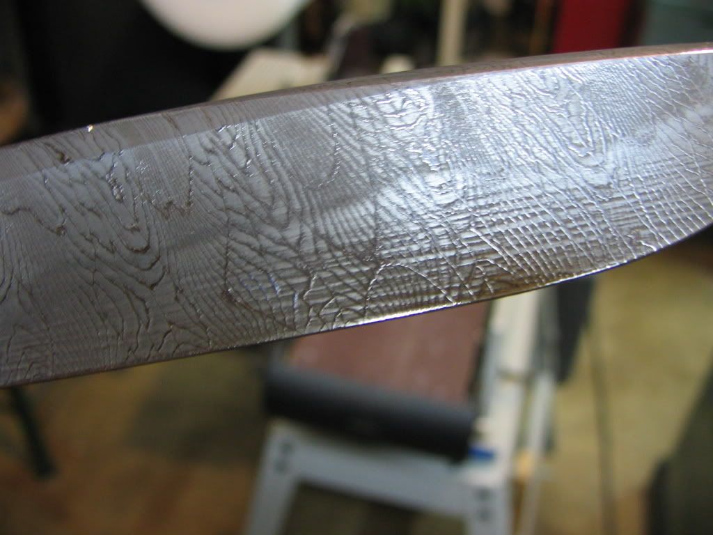

I've been using a bit of commercial Damascus for stock removal knives the last few months, and run into somthing I dont understand. I heat treated 5 blades yesterday- pbc coated at 700, then up to 1475 for 5 min. then quenched spine down, point first in Brownells fast q. 2 draws at 375 for 1 hr.
1 blade was old Parker Edwards scrap -not sure of the makeup- .110 thick.
2 blades were 1080 and 15n20 at .125 thick. The last 2 are 1095 and pure nickle and are .185. After the ht, I noticed that the thicker blades looked like they were differentally hardend- you could see a definite wavey line. I tested them as quenched and found that on the tang, just behind where the guard will be, the thicker blades were 49rc. Cant test the edge because of no flat area but a new file wont touch it so I know its hard. The 2 .125 blades tested 62rc. So after getting the final grinding and sanding done, I etched them all pretty deep and then buffed them. The 3 thinner blades turned out as expected but on the thicker ones I got a bunch of-lines?- running paralell to the edge but only in the hardend part of the blade!!!? Anybody no what causes this? Is it common with differental hardening? I,m pretty new to h. treating carbon steels so any help would be much appreciated.
Thanks, Monty
Heres some pics.
