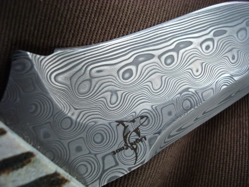

I don't have any experience with Tom Kreins knives. I do have a Damasteel companion XJ made by Greg Lightfoot. I've used it for going on two years now for general utility tasks, no real hard use. It holds an edge reasonably well, is easy to sharpen and has kept it's good looks. Greg told me that mine was RC 58 and that the Damasteel was from Sweden. It looks to be the Rose pattern:
Based on my experience I think you'd be happy with Damasteel as a user.
Damasteel is a very good quality steel for user purposes. RWL34 is very similar to CPM154 and PMC27 is high quality mid carbon content powder metallurgy steel. You can be assured that Damasteel will make a very high quality user as long as it is properly heat treated, and that isn't going to be a problem coming from Tom.
Correct me if I'm wrong, but I believe Tom has Paul Bos heat treat his stainless steel blades -so the heat treat would be spot on. Just for interest, you might want to e-mail Tom to see what his damasteel blades are hardened to (I'm guessing HRC 60-61).
CPM 154 is very similar to RWL34. It is an excellent steel. From my experience, Damasteel (at HRC 61-63) gets initially sharper than D2, holds an edge almost as long and is much more attractive.
Plus, since Tom ground and sharpened it, it should be a freakin razor!
It will work very well as a user. :thumbup:
