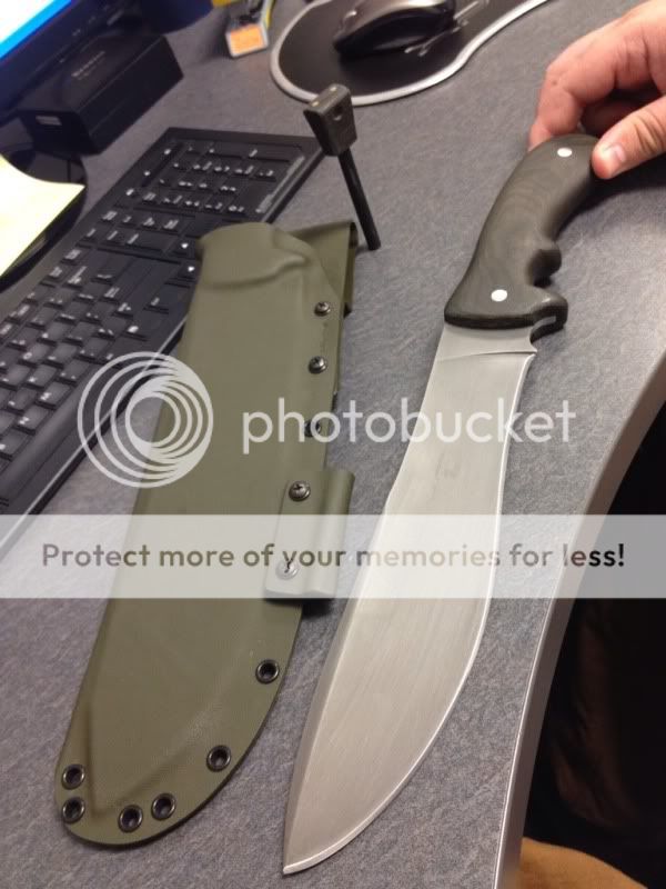

I had a local guy strip and patina the blade, make some micarta scales and matching firesteel along with a striker notch on the spine.
He also saw fit to make a matching OD sheath.
what do yall think?
It is likely voided, but from what I see the end product is more than worth it.:emot-yarr:
Im just glad \I can use it now without getting hot spots. And he gave the handle a nice bulb on the end so it doesnt always feel like its coming out of my hand.
He did a lot of work under the scale to ensure that it is going to hold up. steel inserts to fill the skeletonized voids and micarta fitted around the tang to give it a finished look.
Warranty probably voided yes, an awesome piece you can really use, well worth it!
That is the big blade that I always wanted! Send me a note when you realize that you hate it enough to sell it. ;-)
