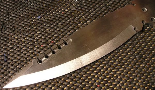

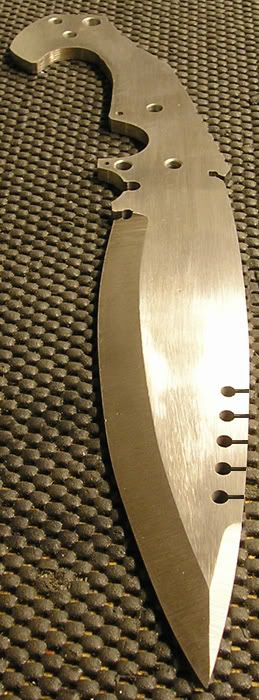

Hi guyz...I thought I might show some pics of the Barong I am almost finished with, next thing to do is make the sheath for it. This is the first exotic style blade Ive ever done this big, so I am happy.
Plus its the biggest blade Ive done to date also. The blade is CPMD2 and shaves my arm,its double ground anf 1/4" thick. Its 14" OAL and has Black G-10 handle scales with Spanner screws holding the handles on. The slots at the tip on the spine are whats sometimes referred to as 'BladeBreakers'. If you have seen Keatings Crossada blowie design, you see one towards the back of the cutting edge on his design. A great design I might add. I made the 1st three Bladebreakers for trapping thinner edges and the last 2 for trapping thicker ones. Anyways... enjoy.
Before the handles....
