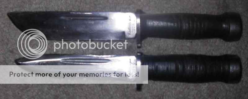

Okay here is a good 'fer instance...' The one on top is an original unaltered US Army Quartermaster knife. Underneath it is someone's sad attempt to make a dagger of it. When I acquired it via Ebay the seller showed a picture of it in its sheath and described it merely as knife shows some use and sharpening but handle is tight. Needless to say had I seen the photo I would have passed it by, and $32 and a few days later I was a little annoyed. Part of the joy of Ebay. The bottom knife was easily the dullest knife I had ever purchased, with the possible exception of some butter knives. The individual who did the damage managed to get a totally different bevel on each side of the knife so nothing was even. A convex bevel on one side and a flat one on the other. No edge. With stones I eventually got it to shave my arm sharp, but was still not happy as it was a barely that sharp.
Then a friend mentioned he had a belt grinder.. A few days later and at least the left side is now equal to the right.
A few hours later with a whole series of stones and a strop and this 'ugly duckling' is easily currently one of the sharpest knives I have ever owned (and I have had many). It is still handle heavy (and I will fix that), but oh wow, is it sharp. Can (and has) easily make a long hair look like a fuzz stick.
