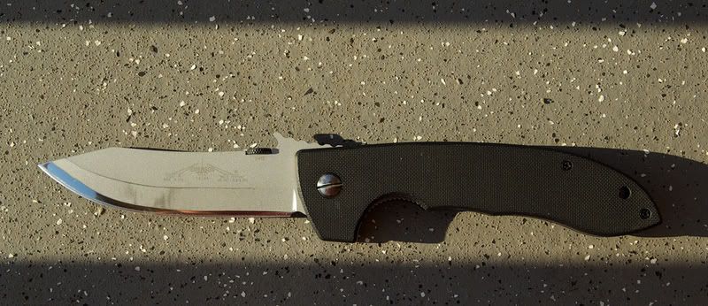

Not trying to start a fight but I would like your opinion on Emerson knives. I have ordered the A100 and it should be here Thursday. This model reminds of Emerson's early Bumblebee model. I have owned some Emerson folders in the past and they had good ergonomics but I had problems with the chisel grind. Seem to work best if you are left handed. I also noticed some problems with their liner locks on the forums. Thanks.

Its not just Emerson liner locks but you hear more reports of the EKIs. This could easily be attributed to the fact that a lot of EKI owners use them harder than others but I don't know about that personally. Most makers and production companies build them such that very little lock engages when they are first opened up new out of the box so the life of the lock is longer before it needs adjustment from crossing all the way across the contact area. So the lock can be precarious if it isn't tested to be sure where you stand. (see my tips and tricks sticky thread)
Otherwise they are on par with other thinner liner locks on the market. I've seen the little knife you speak of just recently and its about the right size for EDC. Once broke in it should be a fine folder. The one here was a bit gritty and grainy feeling to open but I've found this is typical of many EKI folders until they smooth out. I too am no fan of the chisel grind and usually reprofie my primary V grind Emerson folders on the sharpened bevel also so I can sharpen it on the Edge Pro even if it does void the warranty. I have zero use for the chisel except for wood working.

Thanks STR. I may have to change the edge to a conventional bevel instead of a chisel ground. The chisel ground might work for a left handed person but I have not liked it. In fact, I thought the A100 might be double ground.
RKH
STR, I got the A100 Thursday and I like the knife but it has the chisel ground edge. Why ? I can't see any advantage to this edge as ground. The knife is well made with a strong ball detente and the knife has a good feel in the hand as are most Emerson knives but the chisel edge just about ruins it for me. Emerson touts this as a better edge. For what ? Combat ? AS an all around knife edge I don't see it. I would appreciate any insight you might offer. Thanks.
