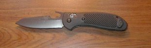

Does anyone have scans or pics of their attempts at cutting a Spyderco opening hole into a "wave"?
I'd like to give it a whirl but I'd like to see other people's work first.

I'm also curious about this... I've been thinking a Benchmade 550 would be quite cool given some grinder time to remove the front part of the hole opener...
do a search, someone did this to their AFCK - but it was butt, and I mean butt-freaking-butt ugly. He said it worked great though. Search under "zip ties" I think, the topic was making a WAVE by attaching a zip tie to the opening hole.
I did a Morgan Atwood conversion on my Delica and it turned out pretty well. I used a dremel and went VERY slowly and kept dipping the blade in ice water to keep it from ruining the temper. My Delica opens like a rocket now.

As Phil said, article was a patent violation, teaching how to, so it went bye bye. But heres some pics of mods -
Above and below are basic Endura mods - just used a belt sander (or dremel) to cut into the hole and then slowly lower the spine so the pocket is guided in better.
My all time fav wave:
Spyderco Civillian with a wave mod. Same idea, opened up the hole, spine reprofiled to look original, and guide well to the pocket lip.
You can also do Griptilian's like this. Any tip up knife with an opener hole.
Here's a Griptilian I did after seeing all the other sucesses with the "tsunami mod".

Ohh, that's awesome....

That Civilian is SICK. Imagine opening that beast in a reverse grip and going to town....

Thanks - was rather pleased with the results of that one as well, and yes, its a reverse grip monster. :D
The knife just has to be carried tip-up (i.e. clip is mounted on the butt of the knife), you can draw it into forward grip, or reverse grip (edge in or out). To draw into reverse grip (edge out) though you have to switch it to the other pocket, the the blade (closed) faces forwards, and instead of pulling up or back on the knife you pull it forwards and up along the seam until it catches at the front of the pocket.
For a standard forward grip or a reverse grip edge in, you either draw it straight back against the rear of the pocket, or you cant it outwards a tiny bit (natural) and draw straight up, catching the "tsunami" on the pocket lip (the latter method only works with LARGE openings such as on modified knives, the Emerson Wave is smaller and doesnt catch reliably except in the former method or the edge-out reverse grip method.)
