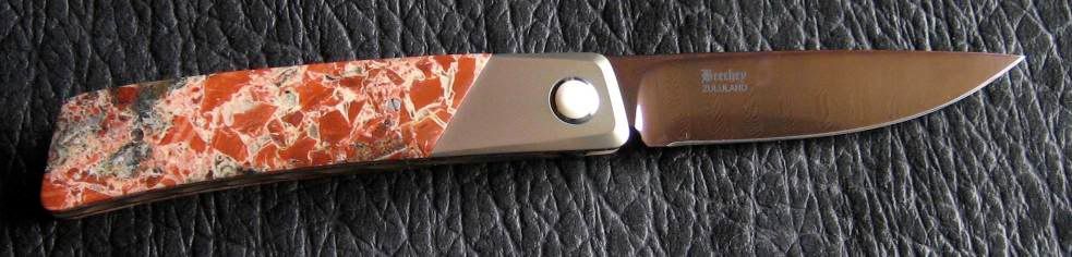

My new favourite handle material for a damascus folder is:
Jasper.
Greg
