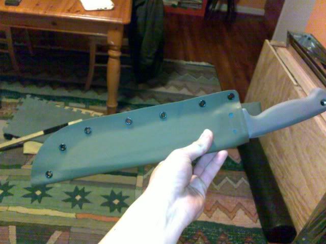

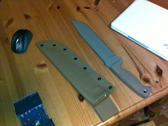

Took me about an hour and a half to make.
I bought the sheath set from Knifekits.com.
Sorry, No WIP, it would only be 2 steps anyway.
I heated the entire sheet of Kydex in my kitchen oven at 300 degrees for a few minutes, checking frequently with salad tongs to make sure it was soft enough.
I dont have a press, so I folded the kydex over the knife, put the kydex-towel sandwich in between the ground, 2 towels, and a sheet of wood. Then I sat on the whole thing for 7 minutes.
Next, I took the cooled down kydex out, drilled holes for rivets, then put the rivets in with the setter tool. Then cut it with a hacksaw blade. Couple minutes on my Harbor Freight 1" belt sander and a file and its done.
Sorry, cell phone pics:
