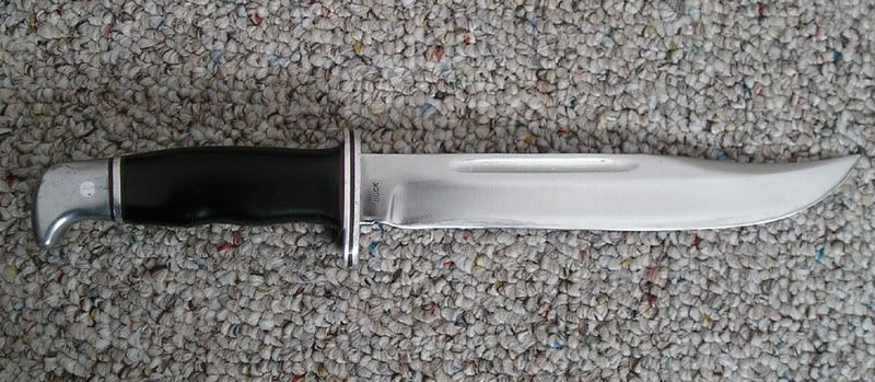

From 1961 through I believe 1965, Buck's fixed blade knives were forged. Starting in 1966 they were stamped. Can anyone give me information as to how to tell the difference? Starting in 1967 the knives had USA stamped on the blade so it was easy to tell from that point on, but before that how?

Mike, good to see you visiting as I have been missing you. Nothing like asking a hard question on your return. I'm use to more easy ones. ;) The short answer is there is no way of knowing. Yet, I'll offer an alternative that has some weight. Which is the Buck asterisk (Buck*). First, Buck has a precedence for using this stamp to note some item of change about the knife which is not always apparent. This stamp was first used in late 1966 or early 1967 to note something. I've seen it on the 120, 103, 102 and 110 and those knives were from this time frame as the original owners verified. I submit it was the move from blade forging to fine blanking as there is no other stamp used at ABOUT that time to indicat this. I ran this by Joe H. and he gave it a maybe. Still, there are many other times the asterisk stamp was used and we don't know why. So, with this no one can give it a no with certainty either. There is some fitting in the time frame that would give it weight. Some items of this nature takes years of collecting, scraps of evidence to figure out and I have been calling and e-mailing persons of knowledge with long time collecting experience on this one. Hoping they could give me a piece to this puzzle. DM

Glad to see you as well. Thanks for your insight. What you're saying makes sense. I've attempted to find differences in the current stamped knives and older ones to try to find parts of the knife that were not as uniform as the newer ones. One observation is a difference in the knife at the hilt where it transitions to the knife edge; On older knives it is short. In newer knives it is distinct and uniform. Also at the hilt where the blade begins, the line is more rounded on older knives rather then a distinct 90 degrees. If one were to place two side by side it may be easier to see these differences.

Here are photos from two fixed knives. The first is from the 1961 -1965 time frame. Notice the short area between the hilt and the start of the sharpened edge.
This next knife is a two liner from some time after 1967. Notice the longer, more distinct area between the hilt and the start of the sharpened edge. I'm wondering if this could be a way of determining the difference.
Mike, Thanks. Your thought of the choil and transition to the blade being more rounded, I think is valid. The early knives requiring much more hand work in that area and during this working could become over worked! Thus, some rounding could occur. Good insight and study effort put forth toward this finding. Wish you the best in your new job. You have a nice stag handled 120. Thanks, DM
