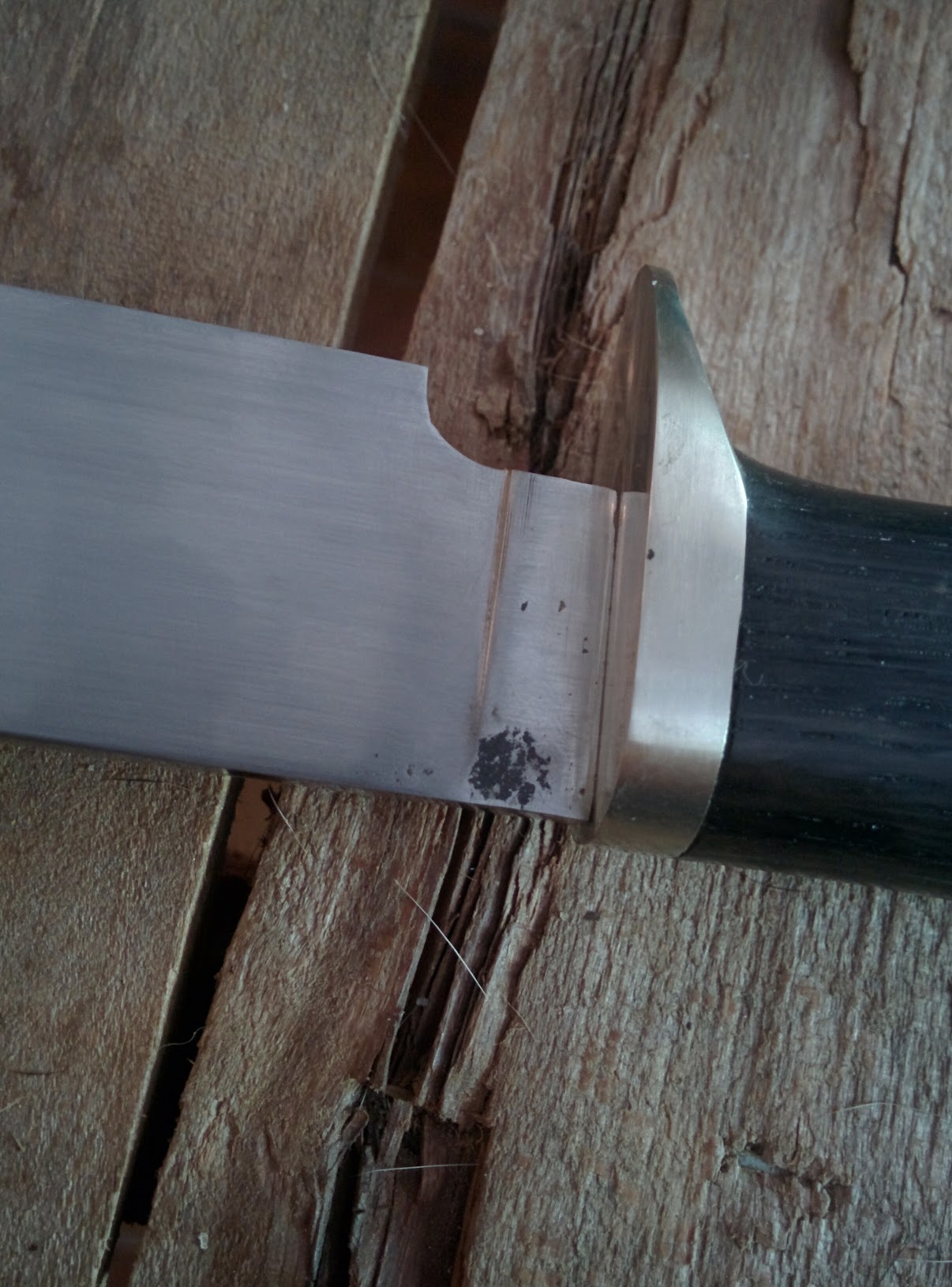

I have a small blemish on my knife from what is a deep hammer mark. I should have fixed it sooner but I didnt want to grind any more material away and affect the fit of the guard. My question is what would you guys do to attempt to fix this or at least make it a little less noticeable? If I could just get the scale out of there I am wondering if it would look a little bit better.
You didn't say if it has been hardened yet, but I will assume it is.
If the knife handle is already assembled, just leave it as-is.
If the handle is only sitting in place for the photo, take the handle off, tape the blade off right up to the ricasso ( several layers), and use a carbide 3mm ball burr to "carve" the whole ricasso in a peened or stippled look. Take your time and cover the area slowly, making divots all over the surface randomly, and slowly filling the space between them with new divots until it covers the surface in a pattern density you like. Don't start on one end and try to make the final pattern as you go ... it won't end as it started unless you are very skilled.
Yeah, I'd just leave it alone and try and do better on the next one. Sometimes, if a blemish is bad enough, it's a lot easier to start over rather than mess around with fixing it.
It looks like the blade and ricasso were hand sanded, but there's some pretty deep scratches in the ricasso too. If you were going to fix the hammer mark, you might as well fix the scratches too. Then you're pretty much redoing the whole thing. This is probably one of those cases to move on and focus on that area more on the next one.

The forged look is big with some folks so no worries there. As an aside, I'd pay more attention to getting out those deep grinding scratches and getting a better guard fit.
Thanks all. I love a forge finish knife but this just looked out of place.
I didnt bother with the scratches because if I couldnt get the scale off I wasnt going to move any further with the finish. This was my first bowie so I learned a lot but fitting the guard was....time consuming.
