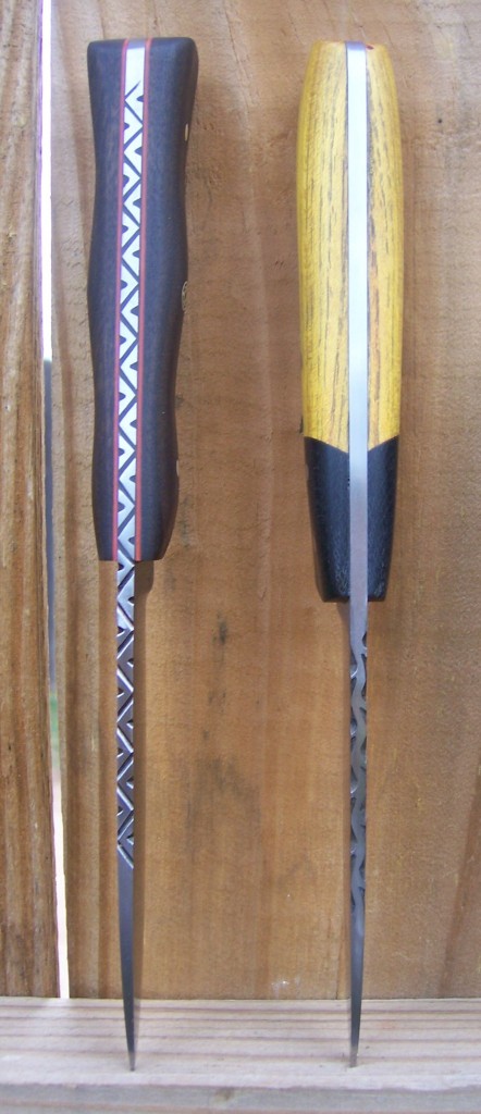

No doubt some of the linked threads talk about the Craftsman 2x42. It's a decent starter machine, IMO. I've learned to make some pretty good knives with mine, in spite of the fact that it's blazing fast. I think it's better than any of the 1" grinders.
Made w/ the craftsman:
