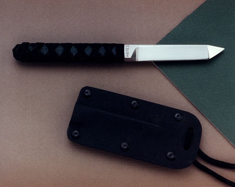

Check out the Hayes Hornet. 175$
I have one and what asolid piece. O1 tool steel chisel ground 1/4" thick.
