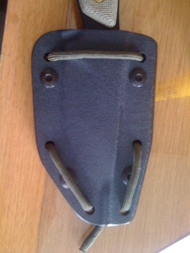

I've just received my new HEST. Unnumbered edition sans book. It's my first HEST. The kydex sheath seems to have two tightnesses for retaining the knife. Upper holes where the knife is too loose to be carried and retained if you were to say stumble of fall, and lower holes where the knife cannot be removed from the sheath even when you loosen the screws and use brute force.

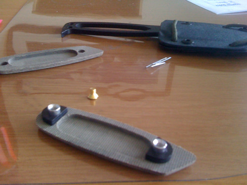

There are little black nylon inserts between the handle slabs as opposed to micarta ones on the mass production version.
Inaccurate. Unless of course you were referring to something else. #105 with Little Black Nylon inserts. I'd venture to say both production runs will have these little black positioning groms:
If your screws are in these positions and you're still having trouble then the kydex was probably molded wrong... I'd lobby for a replacement. Reference Picture:
