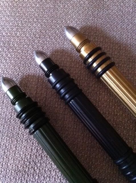

I have been playing with different sizes of o-rings on these pens.
First, for pocketing these little guys and for cap retention--smaller, snugger fitting o-rings are what I like.
Some people may want to "fatten" the grip, so you can go with larger o-rings (or some that differ from a round profile).
Enough word here are some pics.
Variety;
On Green, some larger, square profile o-rings I had around and put on for test fit. Make the pen a bit too fat for my liking, but some may like it.
On Brass, a variety of smaller round o-rings in two sizes--the size I will show in a photo, and one a size larger (unsure of exact size, but it is #6 to the pic #5)
On Black, my preference for pocketing, pic specifies the size.
To help in placing them where you want them, a small piece of plastic, or perhaps, a popsicle stick can he handy.
