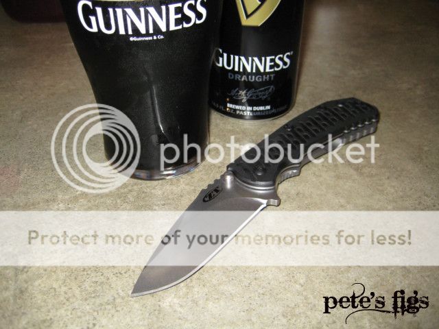

so i got my ZT0550. love this knife. most expensive knife i ever got. i know some of you have knives over 4 times this one, but i'm more used to something under $100.. anyway.. there is a very little vertical blade play. i read the forum on all the vertical play posts. it seems there really isn't much that can be done other than sending it in. however, i also noticed that sending it in does not resolve the issue (i did send an email to ZT CS. i know they are great, but all the post indicates they do what i used to do when i used to work with hardware.. replace the part.. sometimes that works, but sometimes that doesn't).
playing around with it, there are two things that's going to fix the issue. elongate the tang on the blade, or bending the ti lock bar just a hair.. obviously, i can't extend the tang on the blade. i read that you can hammer it.. i guess sort of like doing body work on the old car which thins out the metal and at the same time will extend the length. but i really don't want to do that. it's more or less irreversible.
other option is to bend the ti lock bar just a hair. how do i go about doing that? i read ti has rather good memory as to where it's supposed to be?

problem solved. just some torx bits and bit of tuning, now it locks up at 60-65% solid.
pete
Glad to hear your knife got sorted out.
Just so you all know, there is never a situation where you need to heat the lockbar to bend it - the titanium can just be bent a little further by hand.
Mind you, I don't endorse this, I recommend sending it in if you have an issue.
thanks jimmer. no bending was needed. just had to make sure the lock bar is moving smoothly. for some reason, the lock bar did not fully engage the blade tang before. i took the folder apart, clean it out, and worked the lock bar few times. now it's engaging the blade tang fully.
