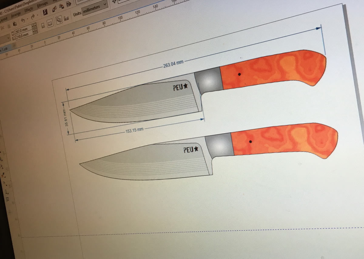

I always start in coreldraw, the few times I start freestyling on the grinder I later scan the blade and vectorize it.
Time ago I used to cut profiles with my cnc router, but nowadays I rarely do it anymore, only if I plan a batch to be lasercut of a new design.
(hopefully this one gets approval from the customer, I plan to use VG10 DPS Suminagashi steel)
Pablo

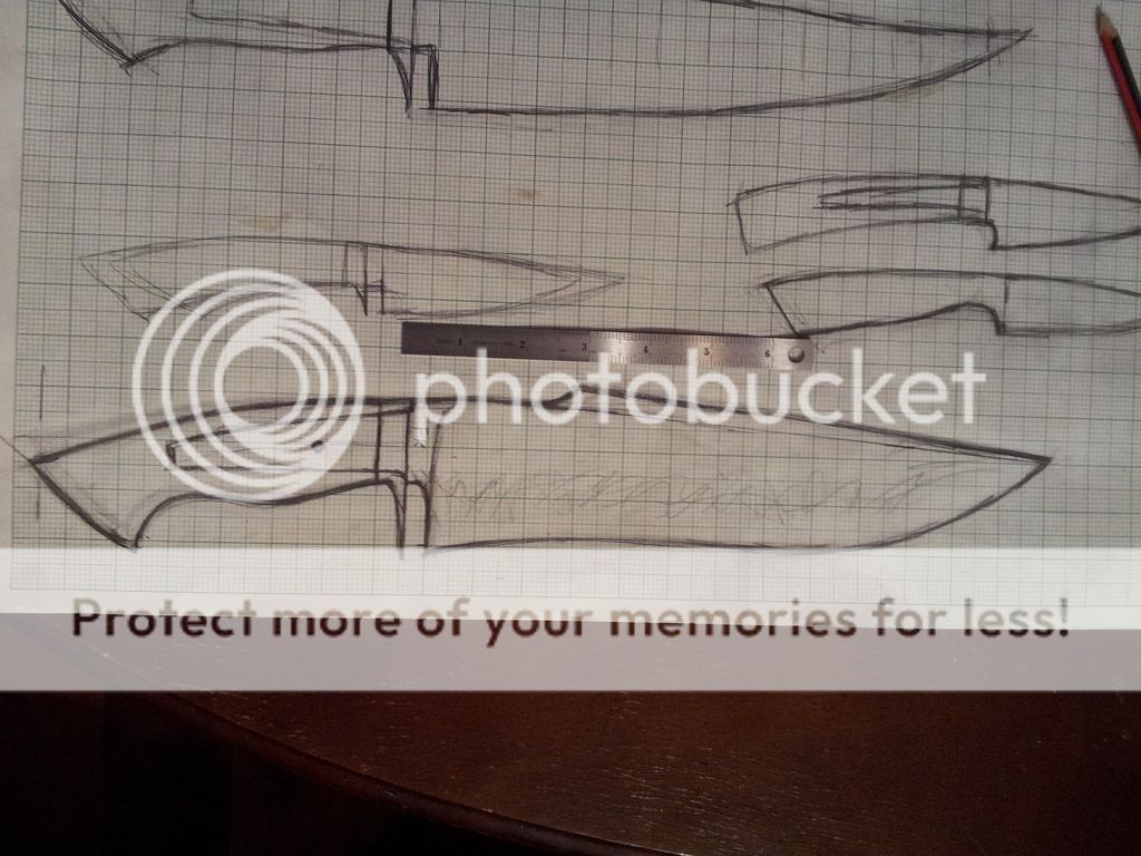

Previously just sketched by hand on grid paper but its hard to get single hard lines on the edges, so I started using some french curves to get a crisp outline of my sketches.
I really like this oversized grid paper :D

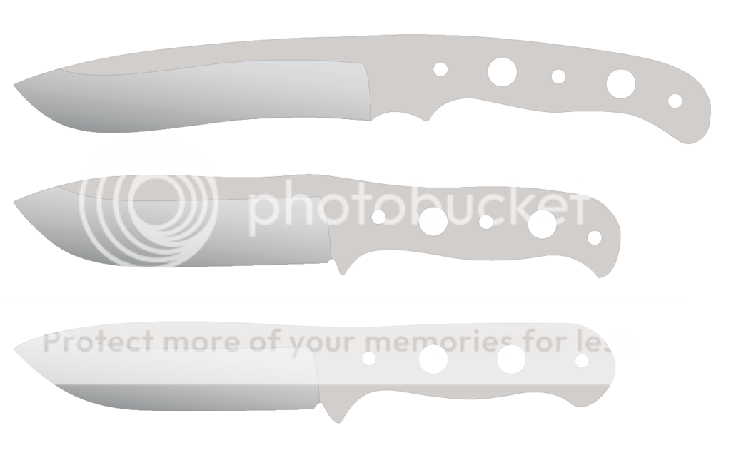

+1 for Inkscape. Pencil and paper will never be overtaken, but benefits of inkscape:
1) Free!
2) SVG format can be opened in the browser, which can help with customer communication
3) Can embed any data in it, such as steel choice, copyright info, and publication date. Useful for historical or search reasons.
It's slow coming, but I'm creating free software resources for knife makers, which will include svg templates, display/form tools, and other stuff that just might make life easier.
