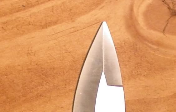

I was opening some mail yesterday in my kitchen and I accidentally knocked my Native off of the counter. Let me just say that a 41 inch fall onto ceramic tile isn't very healthy for a knife tip. When I heard it hit the floor, I was hoping that it landed on the handle, wishful thinking... I guess I'll have to head to Wally World in the morning to buy another one. Anyway, here is the aftermath... :(
I know how you feel. If you drop a knife open, it always, always lands right on the damn tip. I've never dropped one on such a hard surface before, however, and have only experienced the tip rolling over a bit, which was easy for me to sharpen away. I can't help but wonder if the fect that the Native is S30V is what made it chip off rather than roll.
That will sharpen out very quickly if you want to. But you're right, now you've got a beater knife.:cool:
If you are going to use that as a beater, you might consider hitting the sander/grinder and making it a chisel tip.

I actually thought about doing that, and I still might. However, I think I'll give it to the wifey. If I'm lucky, she might get hooked on the knife obsession too!!!:D

I can attest to this. Have done it twice now with S30V blades:( . Don't give up on the knife though! In both cases, it just took a lot of resharpening to restore the tip. Might be a little ugly in the end, but no one said the Native was beautiful to start with.
If you can get access to a belt grinder (or a belt sander turned upside down) it wouldn't be too difficult to grind down the swedge so the tip is pointy again (it'd take a lot longer to sharpen it out from the edge, and wouldn't look as good).
shouldn't be too bad. I broke the tip on one of my other knives and i reprofiled it in a few minutes on a SiC benchstone. You can use diamond or whatever you want.
Grind the swedge to meet the edge.

Thats a small break. You lucked out really. You can make that pointed again with a small dimond sharpener. Just take it down from the spine (swedge) side little by little as you are watching the tube.
