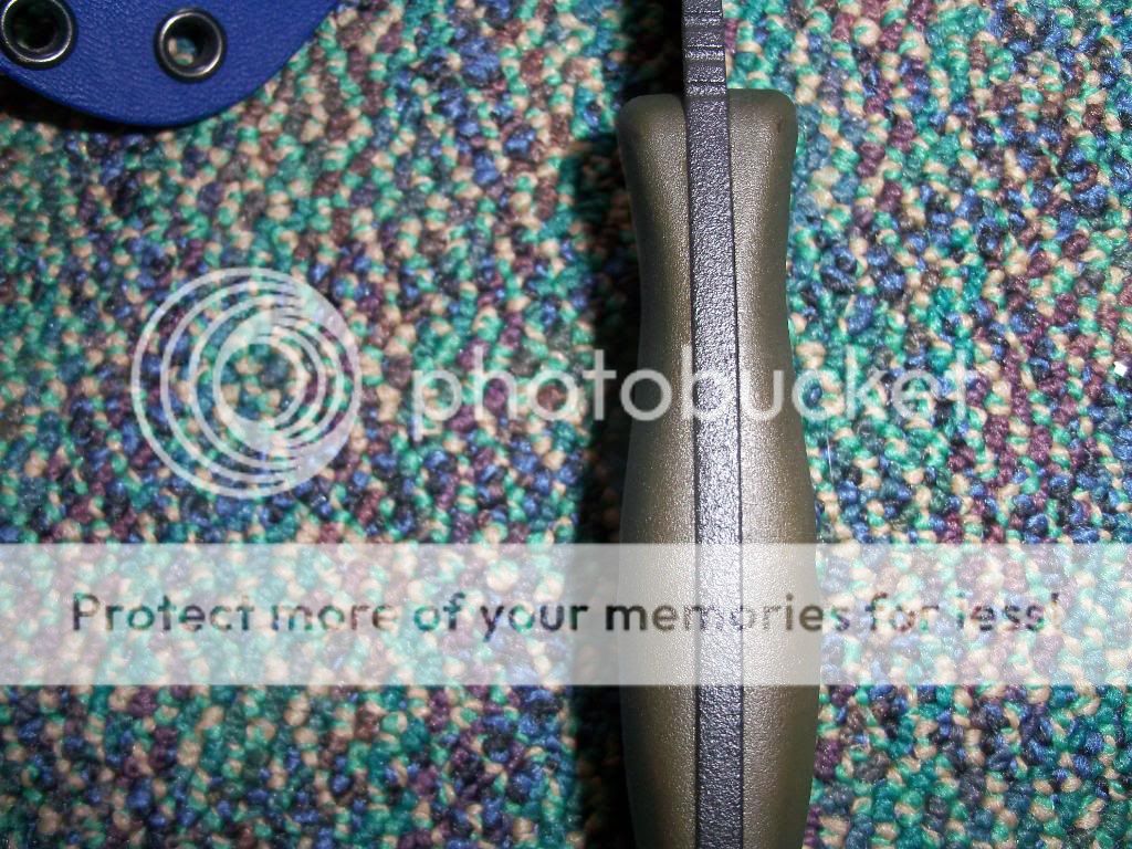

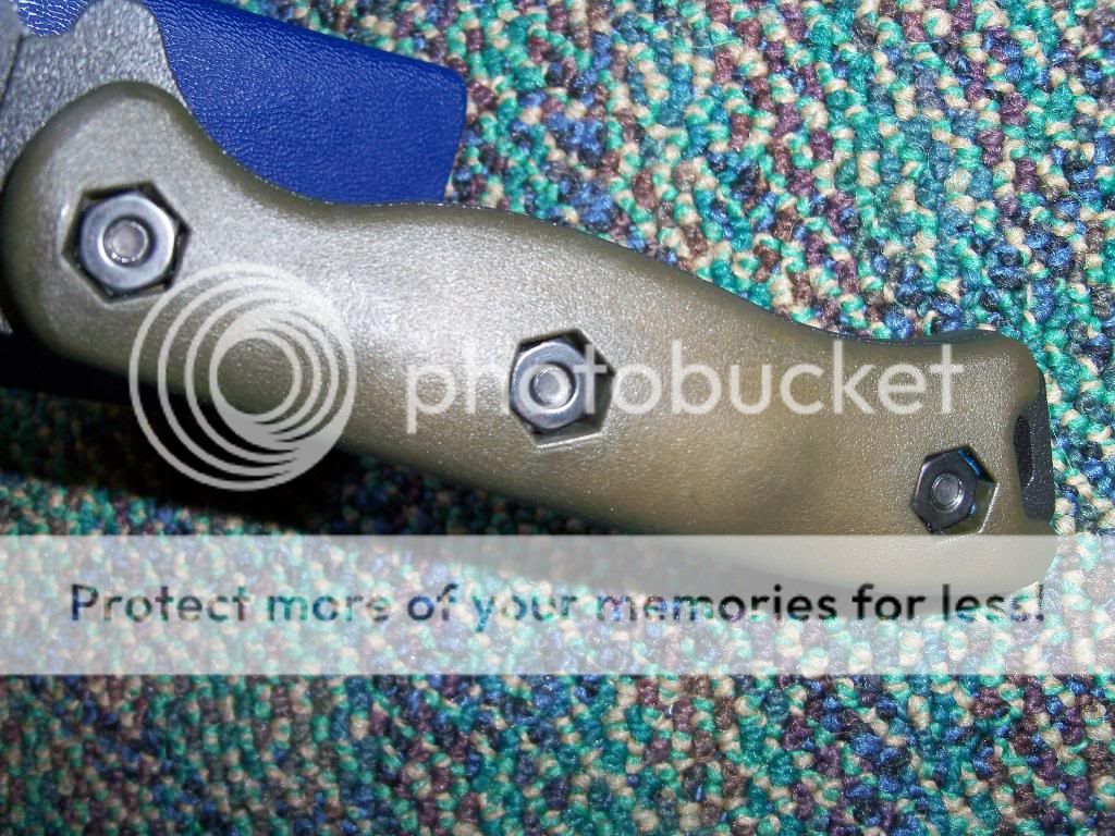

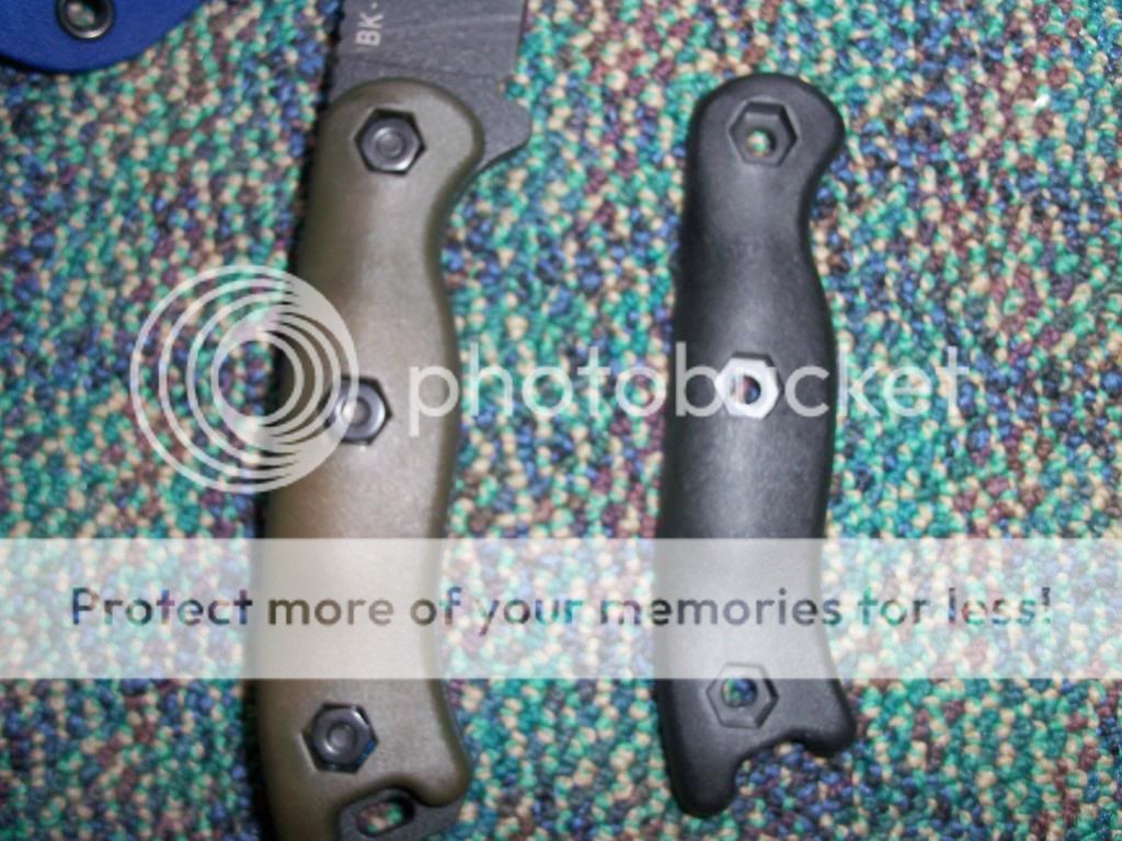

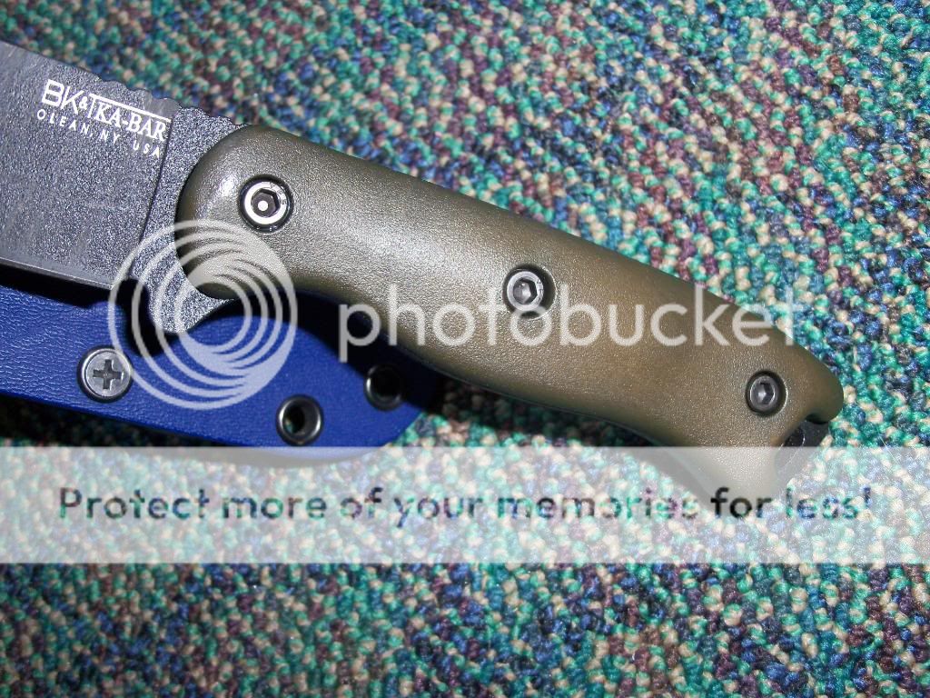

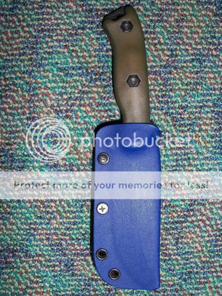

I did dye the peanut butter scales though. I also dyed the stock 16 sheath. Pics on that later.
I used the Dark Brown rit dye.
I put the scales in a pan and poured ALMOST boiling water and the rit dye over them. Let them sit for about 20 mins, took them out, washed them off, dried them, and WHALA!! Just like that...

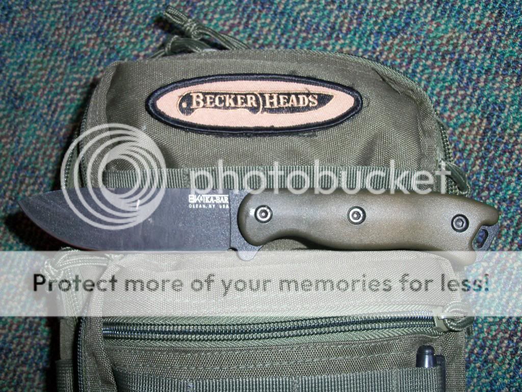

Here's pics o' the scales.
It came out sorta a dark O.D. Green. It's almost the same color as my off duty EDC pack.
