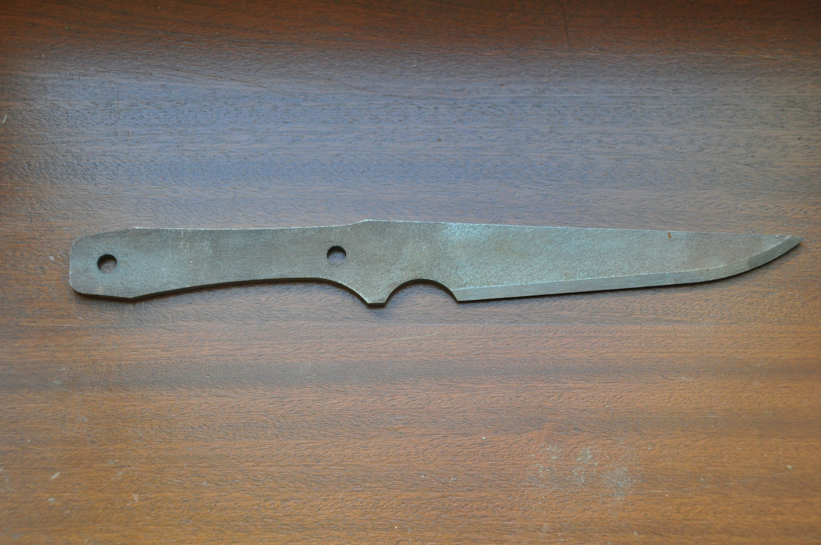

I've designed myself a few throwing knives.
May 5, 2005
954
Because I was NOT satisfied with throwing knives available on market (and their prices :D)
I've decided to get some knives manufactured.
I draw four designs in the begining.
Of course one can find many similarities to other knives that were made earlier - it is hard to bring something completely new.
Knives are laser cut, sharpened, hardened, cutting edge removed, sprayed with teflon to get some rust protection
And this is how they fly...

NOT A LIVE TREE. Just a stump
It is just teflon spray, nothing special.
No "active" rust after being sprayed. Very nice.

I'm aiming at zinc based covering. Inexpensive and delivers great rust protection, even when scratched.
And when it comes to third design - the one with large "choil" - it is the worst flying knives of the pack. :) First time no the charm :)
