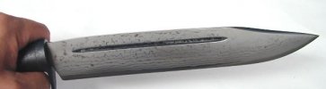

Hello folks. Please allow me to brag my new knife. This is the reproduction of japanese traditional hunting knife.
http://www.imagestation.com/picture/sraid83/pfd4a3199bdd64cbc8a47df7ebe0c9585/fae15884.jpg.orig.jpg
http://www.imagestation.com/picture/sraid83/p405f09cc1b3a7233071b4bc7c4106814/fae15875.jpg.orig.jpg
The blade is 30cm and forged out of carbon steel billet,AOGAMI-super. This is the best steel for cutlery in japan and hardness is HRC65.It is deadly sharp like SUSHI knife! The scabbard is made of the same wood with Katana and well oiled. Personaly I like the shape of Tanto,but the knife with Tanto-point is prohibited in Japan. The blade was slightly convexed for hacking and its back was black-coated for corrosion resistance.
The works of local traditional smiths were tend to be limited to agricultual implements,hatchets, saws and so on.But they began to make utility knives using their trad techniques.Their knives are very peculiar and getting popularity in Japan.The price was about $210. I think it's in reasonable range for practical use. I am eager to test this knife in the woods!

I have used many japanese wood working tools and found them to constantly be of high quality, specifically with very high initial sharpness and overall cutting ability.
I have seen knives such as the above and they are very interesting considering past experience. However I have two concerns. First are possible problems with brittleness with such a hard edge. Second are concerns about warping as such blades are usually made with either iron or mild steel laminates.
Do you have any details on the edge geometry. How thick is the blade behind the edge and at approximately what angle is it ground? I would be very interested in your impressions of the knife after some use. That is a very reasonable price for such a blade.

The blade thickness is 6mm and 34mm in width.The overall weight is 570g but wielding it is far easier than BKT Brute. Weight balance is almost the same with Tanto.
I am not sure about the edge angle, but it seems the same with my old SOG Tigershark with convex-grinded edge version.
Regarding your concerns,I asked smith the same question before purchase. I asked him I should buy lower grade steel model with lower hardness(as SHIROGAMI,AOGAMI). He said some chips might be happen in any steel in hard use,but it will never warp,bend or break thanks to his temparing knowledge. And it was time-tested fact, he said.
