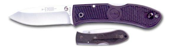

Bob and I discussed this model before the news went public. But the full specs weren' t written out at that time. While I plan to get a hold of one of these, I' d like to know some info from those who have one.
*Is the thumb stud finish rounded/ untextured? Can' t tell from the pic at AGs website.
*Is the pivot pin adjustable? Looks like it uses an allen key head.
*Can someone post a pic of the pocket clip?
Thanks,
N.
I can't do pics, but I can answer questions! The pivot is adjustable via a Torx screw, same as the clip. The thumb stud is rounded and polished on the face, but the radius is stippled/checkered. It works great IMHO. Won't snag on pockets but it's easy to flick open. The clip is shorter and thinner than those found on the Spyderco Delica. Secure and not so noticeable. It is matte black finished.

Just wondering if anyone has gotten theirs who can post more pictures, say of the clip side???

This pic is off the Knifecenter website--not the greatest pic, but it does show the clip side.
Zenghost, thanks for the pic of the clip side. News is there is yet another folder from KaBar bearing Bobs name. Same knife, but with diferent blade shape. Anyone seen one of these?
