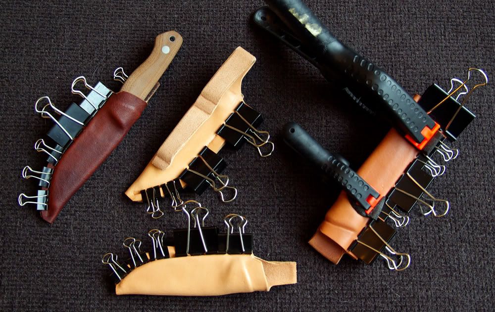

I'm working on some kydex-leather combi's for the Koster Bushie, and this is progress so far.

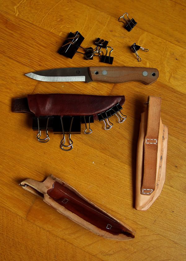

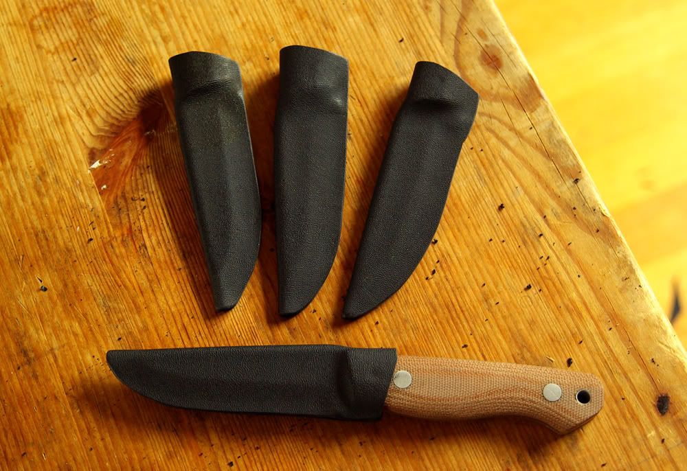

Liners are formed:
Here the leather is drying into shape after wetforming.
3 different kinds of leather I used.
The left one is made of lappleather. it's very thin (1.7 mm), but very stiff and strong. It's the lightweight.
The bottom one is made of 2mm halftanned, the one above in the middle also, and the one on the right is made from 3 mm halftanned. It's still a bit wet, hence the darker color.
After drying, i'll glue and stitch the beltloops. wet it again a bit on the outside, glue it shut and stitch it up. trim it, sand it, paint it and wax it.
There is no retentionstrap, since the blad is very lightweight, and retention is provided by the kydex (smooth klack) and friction will suffice for most outdoor scenario's.
On the upperbeltloop a rectangular ring will be attached to transform it into a dangler. This ring runs freely on the upper loop, and will stay out of the way on the bottom of the loop when not in use.
The beltloop is placed a little to the back of the grip, so it will not interfere when grabbing the sheathed knife. Use your thumb to push it out, for a onehanded draw.

The clamps are there to let it 'shrink to fit'. They'll get all curled up without them.

Okay, I'm just starting to work with leather, so maybe this is an obvious question: How do you avoid marking the leather with the spring-clamps you're using? Put the thread channel across the marks? Or is there another technique?

During wetforming I carve a little gutter with the bone-tool to outline the kydex. In here the clamps will rest, tight to the liner till it's dry. This is also the part where the stitching will be. Prior to grooving I will wet that part of the sheath a bit, and remove the marks as good as it goes with the bone-tool.
To prevent really disturbing marks you'll have to move the clamps left and right little bits during the first hour of drying. That will smoothen things out.
Disadvantage of these particular clamps is that sometimes they stain. But that will be covered up by the paintjob. Despite that, I love these clamps, tried several, but these are extremely well suited for this job, apart from the staining. They became part of the style I do I guess.. Sometimes you see little black dots.. :cool:

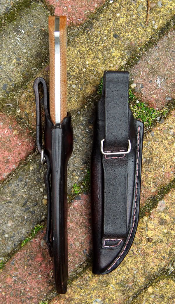

I finished 2 today..
Here's a pic after the beltloops have been stitched, the waxing of the inside.

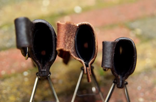

Three cups in a row showing the difference in thickness. The lappleather, still untreated measures 0.06" or 1.5 mm. Taht'll be a slick one.

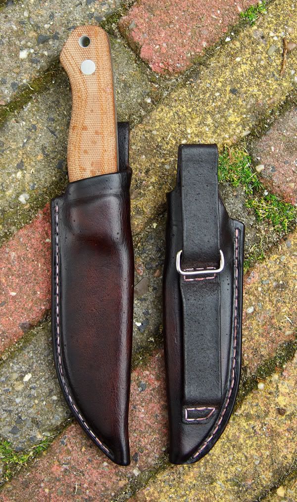

The finished sheaths

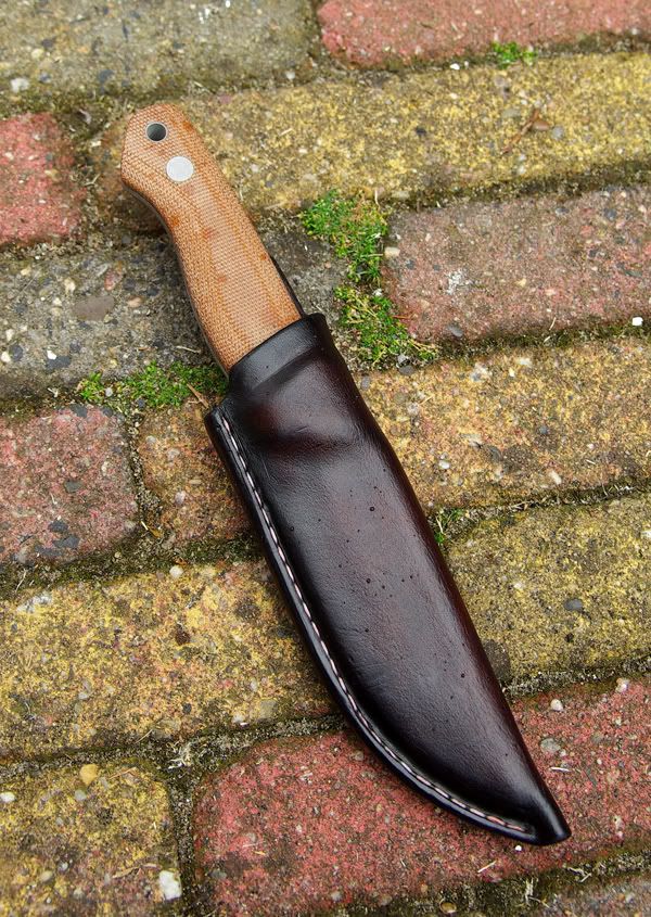

The left one is made of a heavier grade leather, and weighs 66 grams (2.32 ounce). The right one weighs 52 grams (1.83 ounce), and is a liitle more compact also.

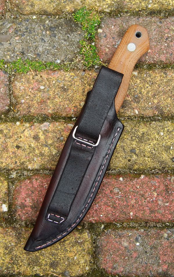

The ring to attach the dangler too sits out of the way
Starts to rain a bit.. Heck, they're made for that :)
Easy to grab with four fingers, and pushed out by the thumb.
Small sheaths do enhance the toolmarks indeed :foot:
Retention is fine. No rattling or fear of losing them, but easy to draw one-handed.
And they're all integral. Made from a single piece of leather. Even the small welt is made from the same piece..

Beautiful work, martin, you've raised your bar again. Do you have any pics of the square-bottomed sheath?
Not yet.
I don't know for sure if I like it enough. To be honoust. I never used the thonghole on my BRKT sheaths (which are roughly the same on their bushcraft models), so why make one?
Unless it's a special request for someone who is determined to have a square bottomed sheath .. ;)

Not that I'm any expert but why don't you get some small diameter rubber tubing (surgical), slit it and slip it on the lip of the clamp. I just thought of this because I love those suckers too but hate the marks and having to move them.
