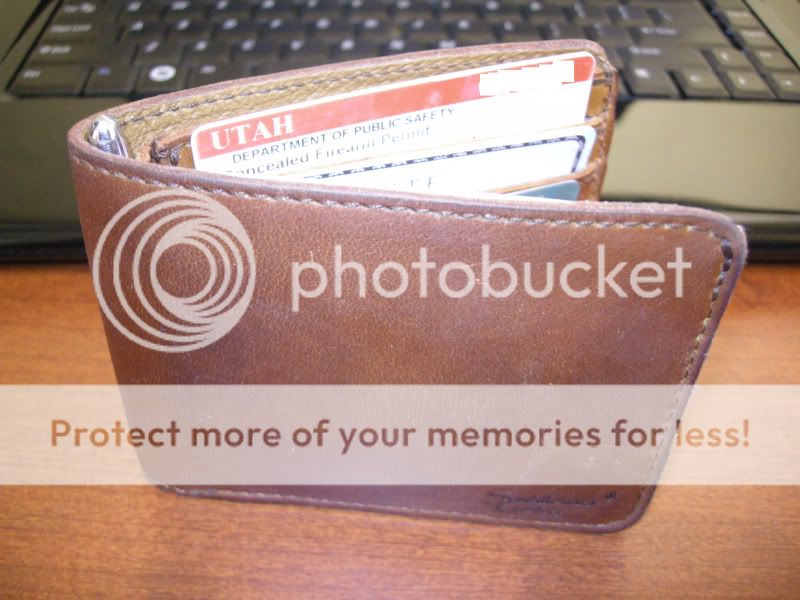

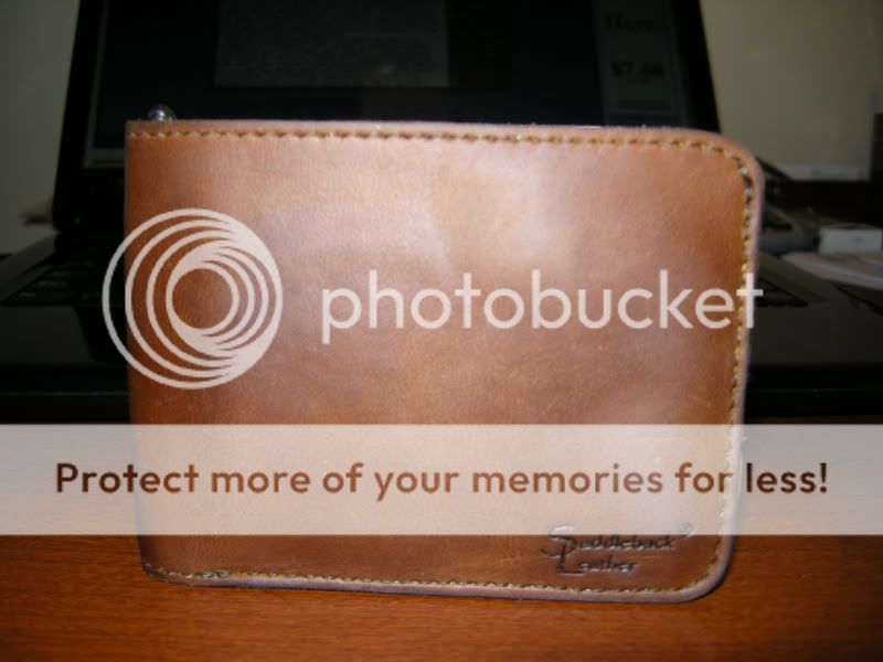

After receiving my new SBL medium bi-fold (tobacco), a couple of drops of water found their way on my wallet. I noticed a couple of raised patches where the water absorbed into the leather. They were not stains but looked like welts. This really bothered me especially since SBL says that they apply Chamberlain's Leather Milk to all products prior to shipping. This should have protected the leather as the wallet was literally in my hands for 24 hours after receiving it directly from SBL. I have a tub of Pecard's Leather Dressing in my shoe shine kit and thought to give it a try. Before applying to the wallet, I called Pecard's and asked how it would affect the leather knowing that SBL is chromium tanned leather. The gentleman I spoke to assured me that the ph of Pecards was neutral and that the oils would not interact with the stitching or leather. (apparently Pecard's has been getting a lot of calls from SBL owners with the same questions).
I applied the Peckard's with my fingers and worked it into the leather, including the areas behind the credit card slots. It darkened the leather somewhat but gave a nice looking patina quality to it. I then inserted my cards and left the wallet in the closed position overnight in a plastic bag under about 50 lbs. of weight (I used two bags of lead bird shot). The next day my wallet now remains closed and is nicely broken in and very nicely water repellent. I then finished the edges with Fiebing's leather edge dressing (dark brown) and feel like I have a wallet that will last a very long time.
