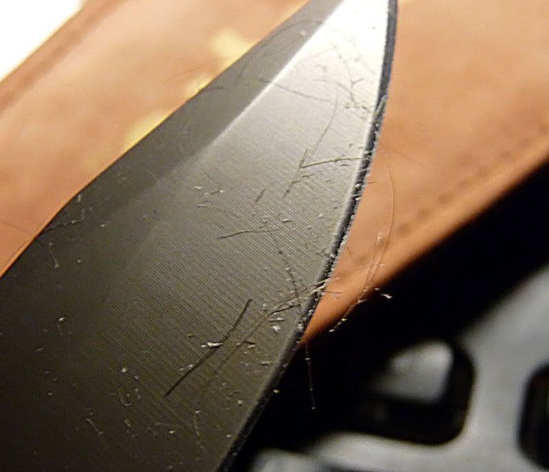

1. How do you guys re-sharpen the recurve blade? I don't have any fancy technical sharpening thingy and do it freehand. I taped a fine grit sand paper and stuck it on a round aluminum rod and followed the contours of the blade. Anybody wanna share how they do theirs? I'm all for more efficient and simpler methods :thumbup:.

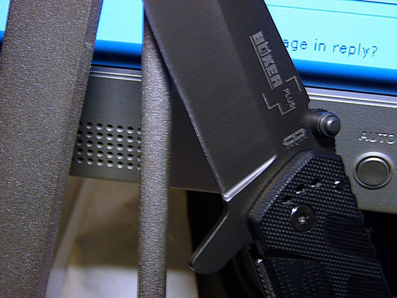

For sharpening recurves and hawkbills i use the 204 set & duckfoot from spyderco ( duckfoot is diamond coated for more agressive touchup's). I strop on a tube of clay coated paper.

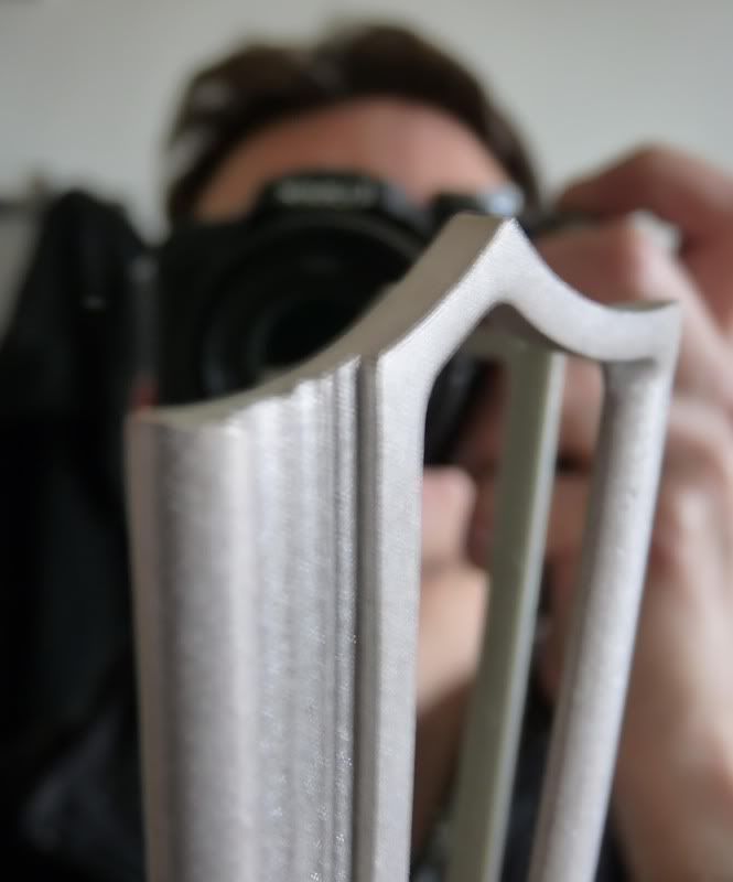

I would be very reluctant drilling holes in the lockside metal . It could result in to weak a handle with minimal weightloss.

As for sharpening the recurve....I got one tip por you dat I gabe to my priend in Slobakia...okay...ehhhhhh, do you hab a sharrrrrrrpening shtone? Ip you do, hold de shtone bertically and den ehhhhh, angle/tilt de shtone (you can use a protractorrrrrrrr to get de angle) den use de corner ob da shtone to sharpen! Dis works just like de...ehhhhhh, Sharrrrrpmaker! I hab done dis bepore to sharpen my Spyderco Police bepore I got de Sharpmaker and it works!!! :p:rolleyes::D
Seriously, it does work, even on serrations...let me know manong how dis works...

Mtype overall weight is 130.41 grams approx. lets say the liner is 25 grams ( i dont know) . cutting holes will say loose 50 % weight makes 12.5 grams. I don't know if that would be worth the trouble?

The duggiefootie might come in handy . AS u zee iz haz roundez corners so alzeu viry goud for zzzerrazionz...
