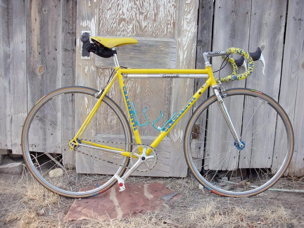

Ha ha. I think a singlespeed is fun but I can't imagine having one as my only (or even main) bike. I like my gears too much.
I do have a SS....it's a roadie though.
Edited to add:
