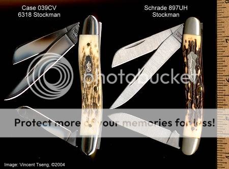

For a traditional folder the Stockman probably is a very good choice for a multi-blade. 3 knife blades on two backsprings and mostly pocket-friendly slim:
a now collectible Schrade Uncle Henry Signature stockman 897UH shown with a Case 6318 pattern stockman with CV steel.
My long time "favorite" (cough! splutter!) person on rec.knives has been an advocate of the Stockman pattern and Case CV steel. He sharpens the blades with different angles - and he does things like opening cans with one of the blades! :eek:

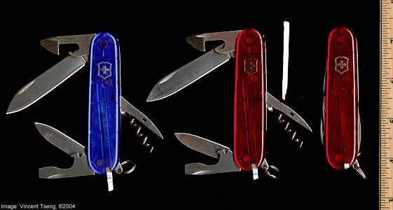

I like SAKs - the basic Victorinox Spartan (low priced at about $14!) actually has a spear point large blade and a small pen blade that artsig1 likes so much....
along with screwdrivers, reamer/punch, corkscrew
and a proper can-opener -
some translucent Spartans -
From all my years of handling slip-joints I have not found anything that beats Victorinox SAKs for consistently good action - at least no where near their price.
Try something like their SwissChamp and know how difficult that is to do.......
and all that for about $40!
