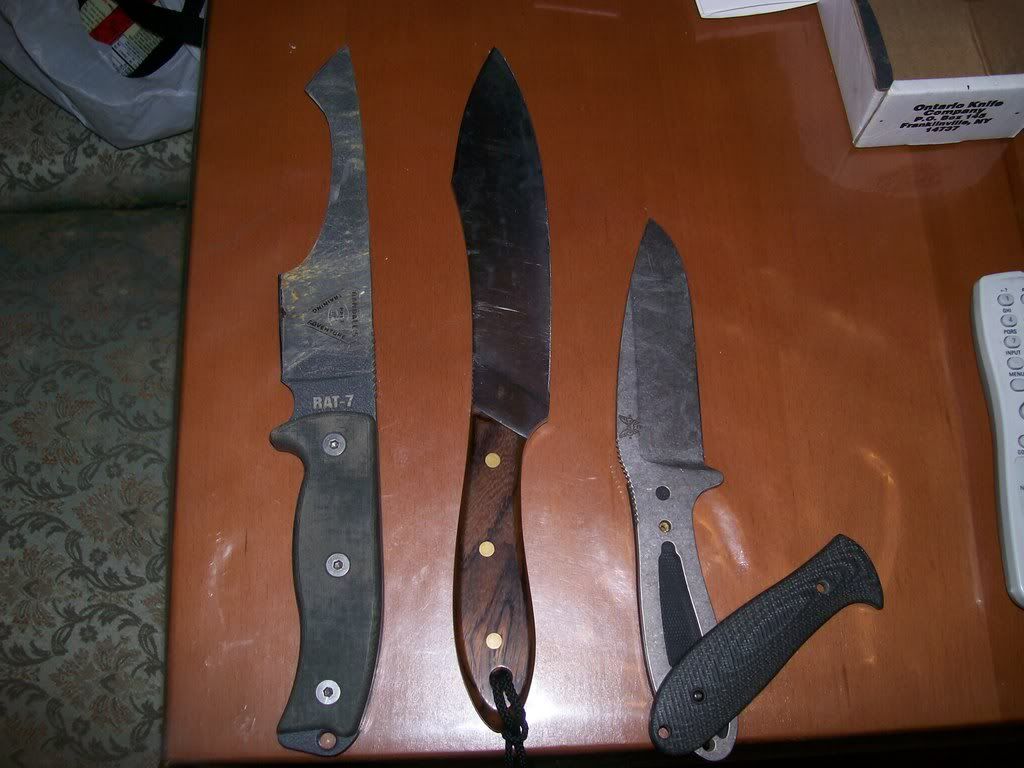

My damn RTAK broke!
Oct 3, 2006
679
I thought they were designed for batoning, but I guess I was wrong.
She broke in sort of an S shape ending at the rear of the serrations.
WTF?
Was I wrong to baton with this thing or not?
How is Ontario in dealing with this sort of thing?
I also have a RAT 7 and a RAT 5. Can I rely on these or banish them to kitchen duty?
Thanks,
Dave

Got any pics of the break? Morbid curiousity...
What were you batoning? Did you have any flex in the blade as you were batoning?

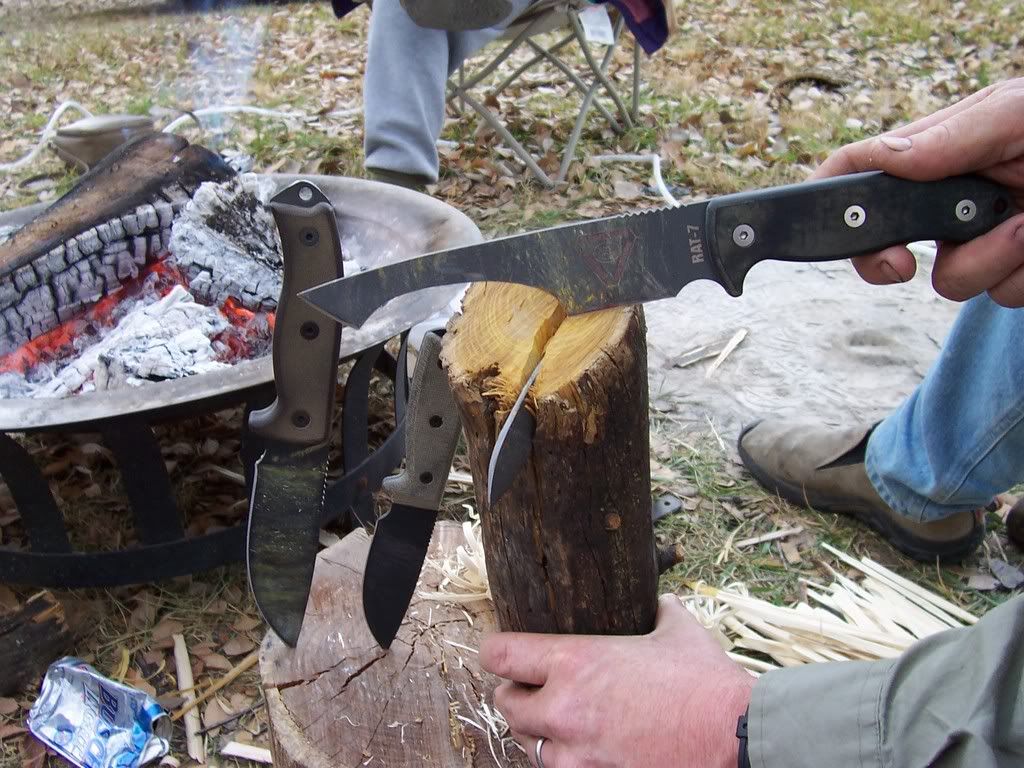

Here is a pic of my rat -7 that broke while I was battoning a 3" or so round of mullberry at camp site.
Mine was made out of d-2. I had it just a week when it broke. I chatted with Mike Perrin from the rat team and he got me a new one only this one I asked if it could be in the 1095. Well when it came in I took that knife out and beat the crap out of it and I still have it but it sits in my collection since I started making my own knives. It is a good thing that the rat team left the ontario company and went with a different knife making company. I will not buy from ontario again ever.

WOW. I never saw a break like that. Serious defect. Out in the middle of know where and have to rely on that. I don't think so.
This kind of thing happens, especially with production knives that are produces in the the 10's of thousands. Stand up companies offer warranties and others do not. Contact Ontario and see if they will make good. If they don't then you have the right to complain. If you haven't contacted them and given them their due - then this post is premature IMO.....

When did you buy the knife and What were you batoning?
Bought it about a year ago although it had been sitting unused til recently.
I was batoning a pie slice shaped piece of seasoned hardwood that had previously been split with a maul.

I`ll take pics after the sun comes up.
No flex in the blade at all.
It was only the third time I had batoned with it.
