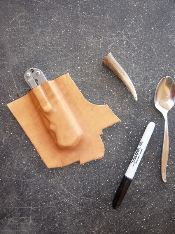

I've been tinkering with leather for a while (I've made about half a dozen fixed blade sheaths and a few holsters so far), and I decided to do something different for a change of pace. I read Gary Graley's sticky at the top of this forum, and watched a video on YouTube and decided I would make a sheath for my Sebenza. Since I was taking a lot of progress photos to send to a friend and I have not ever posted a WIP thread, I thought this would be my chance at fame and fortune (or at least might help some other newbies to learn from my mistakes and to get motivated to give this a try.) If anyone sees anything I did wrong, please feel free to correct me.

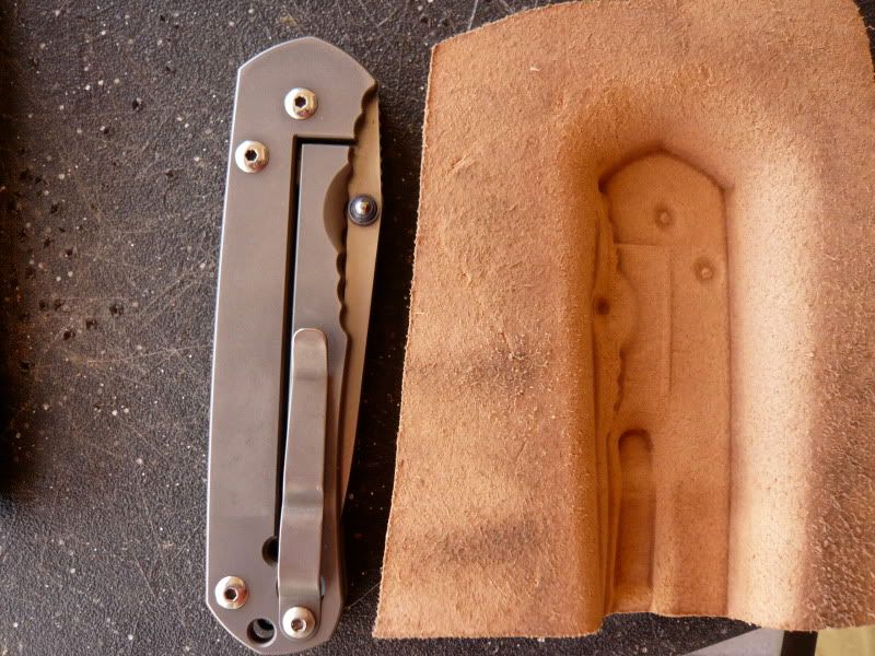

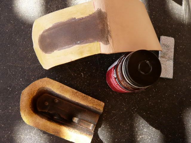

I started with a scrap, randomly sized piece of leather and went right to work getting it wet and molding it to the knife. I'm not even out of the gates yet, and I've already made my first mistake...I did not remember to cut a decorative groove along the top edge of the sheath, and I'm not sure I can do it now without screwing things up so this one will go without. I use the pictured tools for detailed molding once the leather surface just dried to the touch and was properly 'cased'. For some reason, the old spoon works about the best for me so it gets the most use.

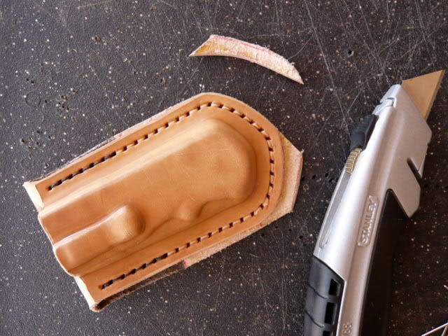

Next I cut away the excess and cut out the back piece, dyed the inside of the sheath and the belt loop, scuffed up the smooth leather with sandpaper and applied Weldwood contact cement.

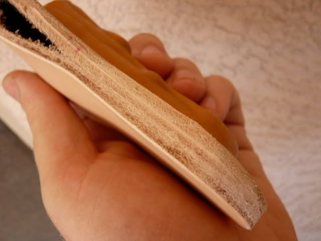

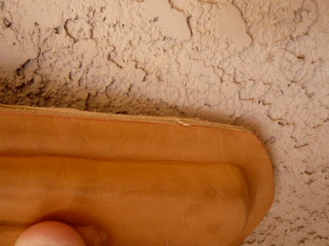

Once cemented together, I trimmed the excess leather away and made my second mistake...I got sloppy with the utility knife and goofed the cut. Thankfully, there was enough excess material to play with so I sanded it down on my belt sander and got rid of it.

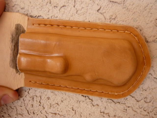

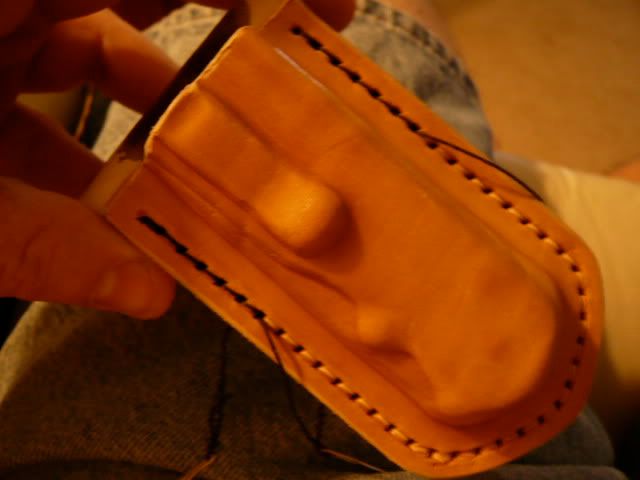

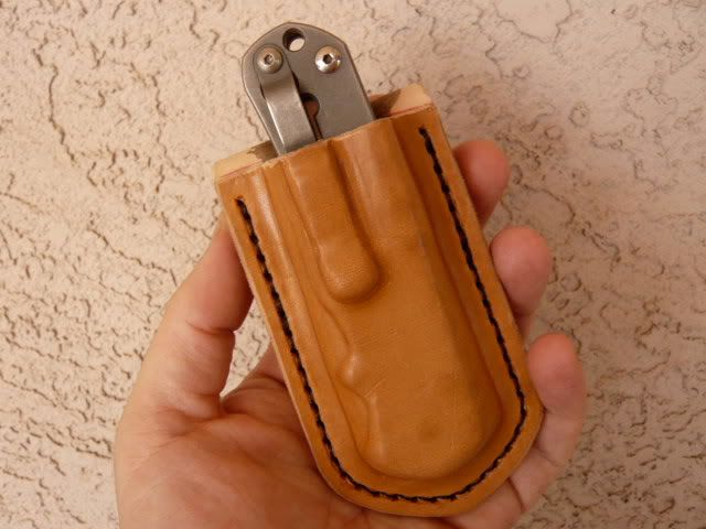

Here I've made the stitch groove, marked the stitches with an overstitch wheel, and punched the holes with a diamond punch. The hole at the top left is a little off, but some massaging with the overstitch wheel helped and is not too noticeable after stitching.

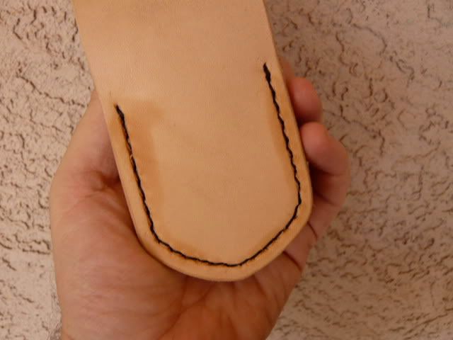

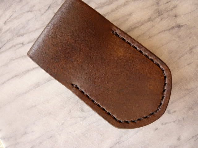

Now it's time to stitch just the front side only up to where the belt loop ends. You don't want to stitch this area into the back piece, or you'll not have anyplace for your belt to go!
Here I'm checking to make sure it's going to fit my belt. I goofed this part up as well...when I went to stitch the rest of the way down, I had to back stitch into this area so there wouldn't be any gaps and I hadn't thought it out properly beforehand. Luckily, I was able to add another stitch hole/stitch and my belt still fit, but I'm going to have to think it through more carefully the next time so I get it right. I'm still not sure what I did wrong.
Trimming off the excess after gluing the back piece in place...this time more carefully with the knife...and sanding the edges smooth on the belt sander.

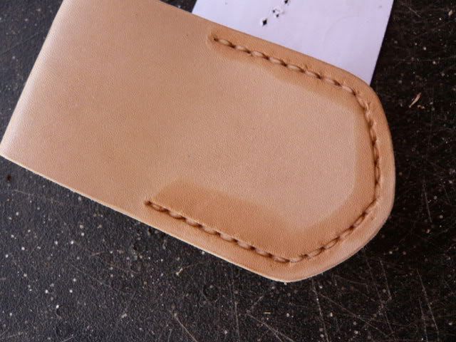

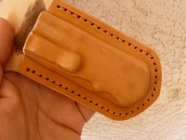

Here I punched back through the front side holes creating the stitch holes for the back piece, cut the stitch groove, and used the overstitch wheel to mark the stitches.
All stitched up. I go back over the stitches again afterwards with the overstitch wheel, dampening them first, as I learned from Chuck Burrows' DVD (excellent for new leather makers.) This helps to makes them more uniform and sit lower in the leather.

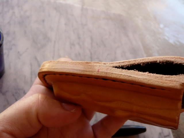

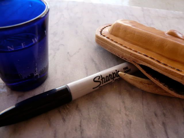

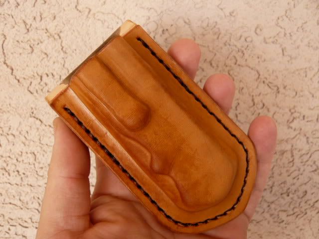

Here I'm getting ready to burnish the edges. You can see where I've burned the edges a little by running my belt a bit too fast (see edge just above Sharpie marker.) I find a sharpie and a shot of vodka (OK, it's really just a little water) works as well as anything else I've tried for burnishing. I will burnish again after dyeing with Gum Tragacanth.
If you squint carefully in this photo, you can see where I've already burnished the left side but not yet the right side. I go over the edges by hand with 400x sandpaper before I do this step.

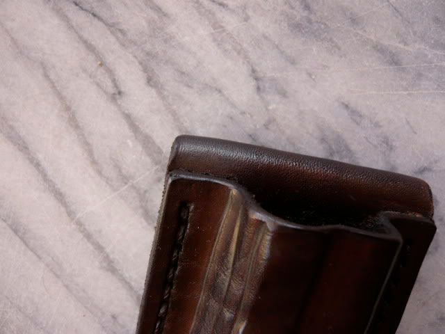

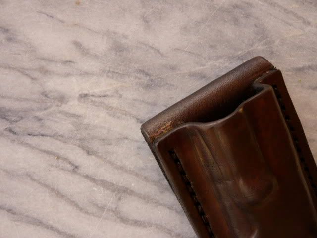

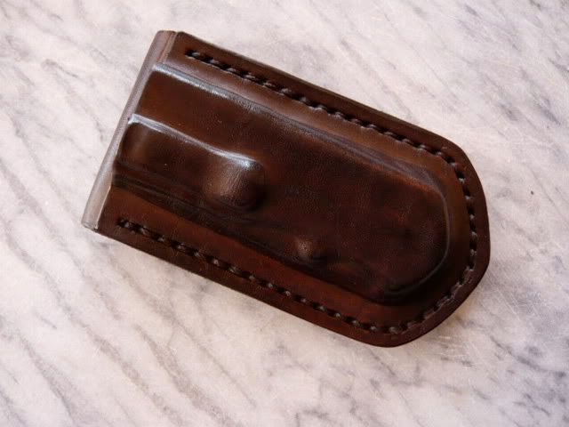

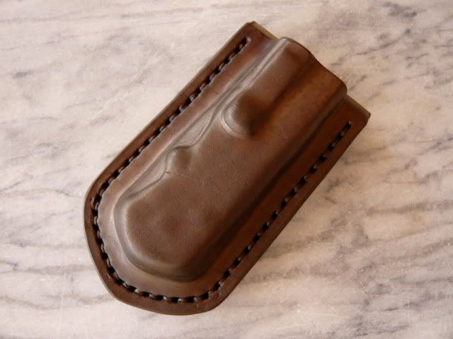

Here is what it looks like after 2 coats of Eco-Flo dark brown. It's somewhat mottled and has a bit of an iridescent sheen, which I've come to expect from this dye. Buffing and top coat will help with those problems, but not entirely. Also, at the upper left where the top and bottom pieces meet it looks like I had some excess contact cement which prevents the dye from taking. Another thing to be careful of...
PJ...good job, it looks great. My only question/concern.......and it is just that because I don't know the answer to it....is if it wouldn't be better to stitch closer to the shape of the actual knife (?)
I have one very similar to yours on the drawing board right now....only it will have a metal belt clip......and I"m planning on stitching right on the molding line.
I'm thinking the pouch may loosen too much, in time, if the line of stitching is too far from that line. :confused:
Thanks for the compliment, rayban! I'm not sure to be honest with you. I think it will be OK as it's borderline too tight now with the very detailed molding (especially around the pocket clip), of course over time I'm not sure and you may be right. I guess I think/hope it's OK, although if your fit is not as tight stitching more closely would certainly help avoid loosening over time.

Any pics of the finished product with the knife in it? Looks great! Good job!
Thanks for the kind words. It actually isn't quite done, so no finished pics quite yet. I have to put on the top coat and buff it, then it will be done. Hopefully I will have pics in the next few days...

Worst case....IF it does loosen, you can still add that row of stitching at the mold line....it may look pretty cool with a double row of stitching.:thumbup:
