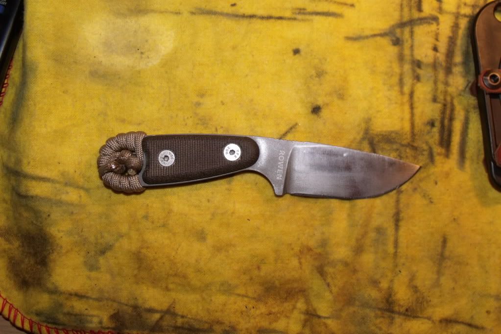

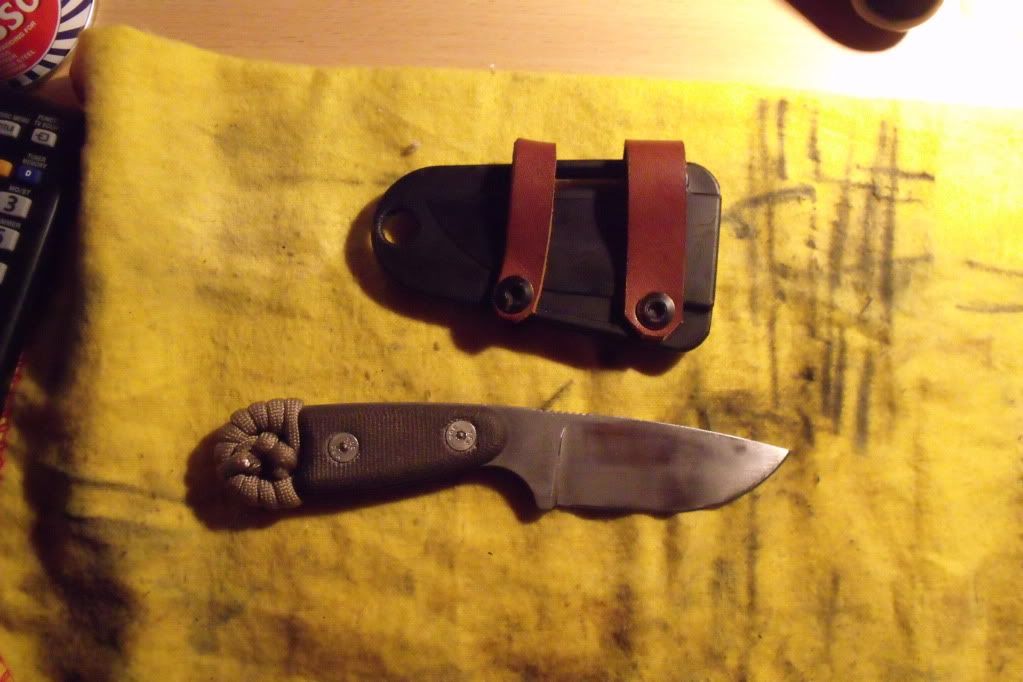

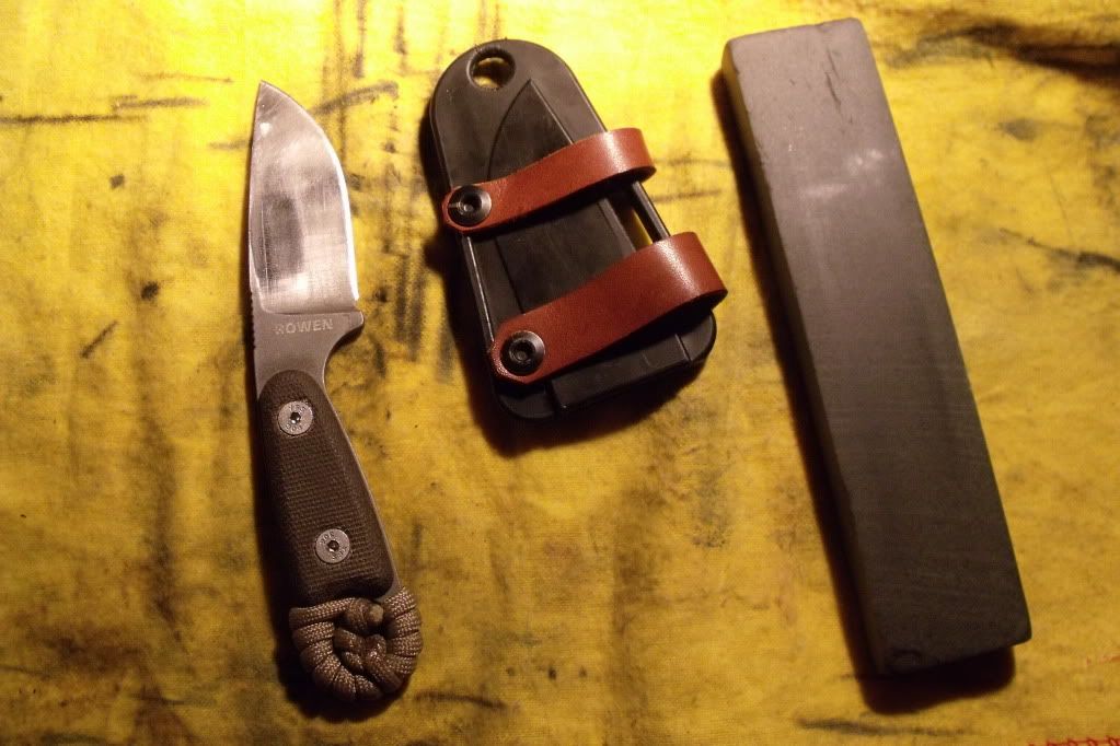

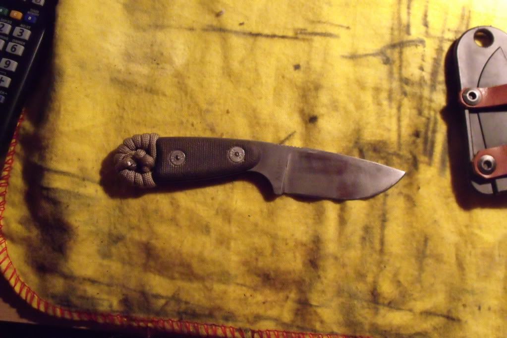

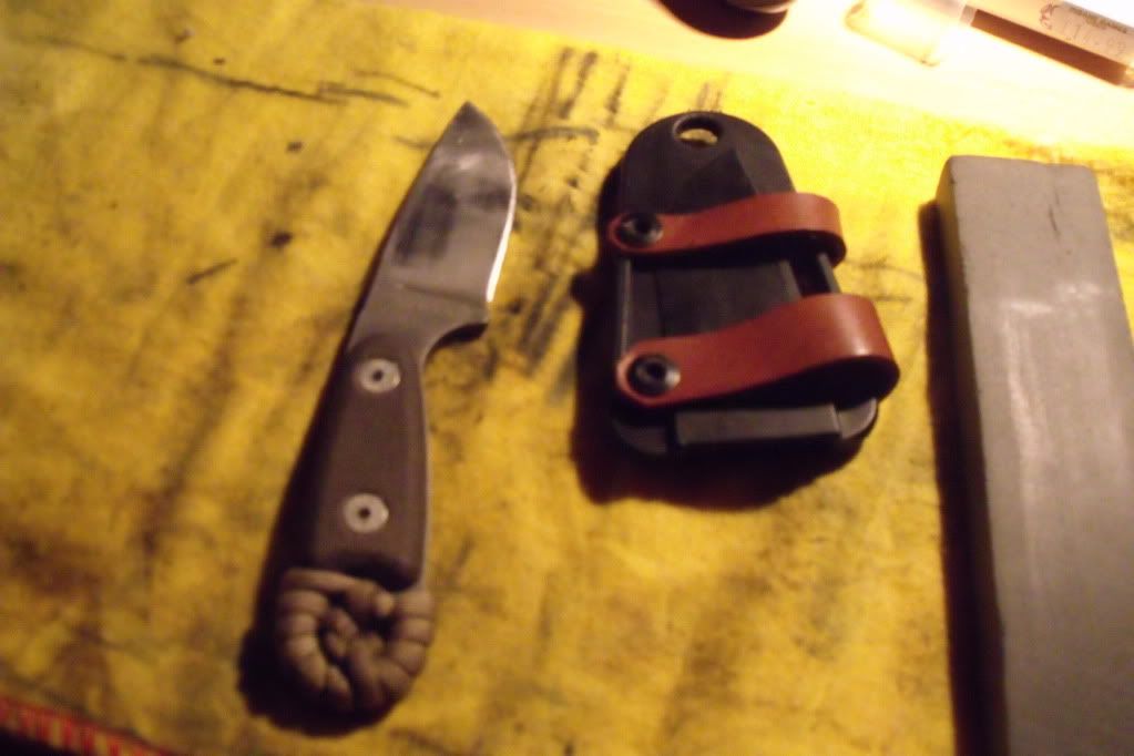

hey guy im new to bf so 1st , hi :)
i wanted to show u guys my izula and wat iv done to it and ask for some advice.
so i striped the paint off it and i want to get a realy good shine on the blade but i dont no how. iv tryed an oil stone (thats in the pic) and sand paper and wire wool but its taking hours and i was wondering if theres a faster way?
and tell me wat u think of the mods i made. :thumbup:

pretty much need a buffer to get it all nice and shiny you can use finner and finner grit wet dry paper but its gonna take forever. a buffer and some polishing compound and more like a hour or so.
good luck and welcome
cricket
Looks good! I recommend starting with 400 grit sandpaper, moving to 600, 1000, then 15000 and hitting it with some polishing paste like Flitz or MetalGlo. :)
Wow, you turned your Izula into red x's!
Haha, that made me LOL in real life!
edit: Oh, and welcome! Use a buffer or get a dremel and buffing tools/compound. You could also try jewelry repair shops for super high-polish powders like chromium oxide that they use for jewelry.
