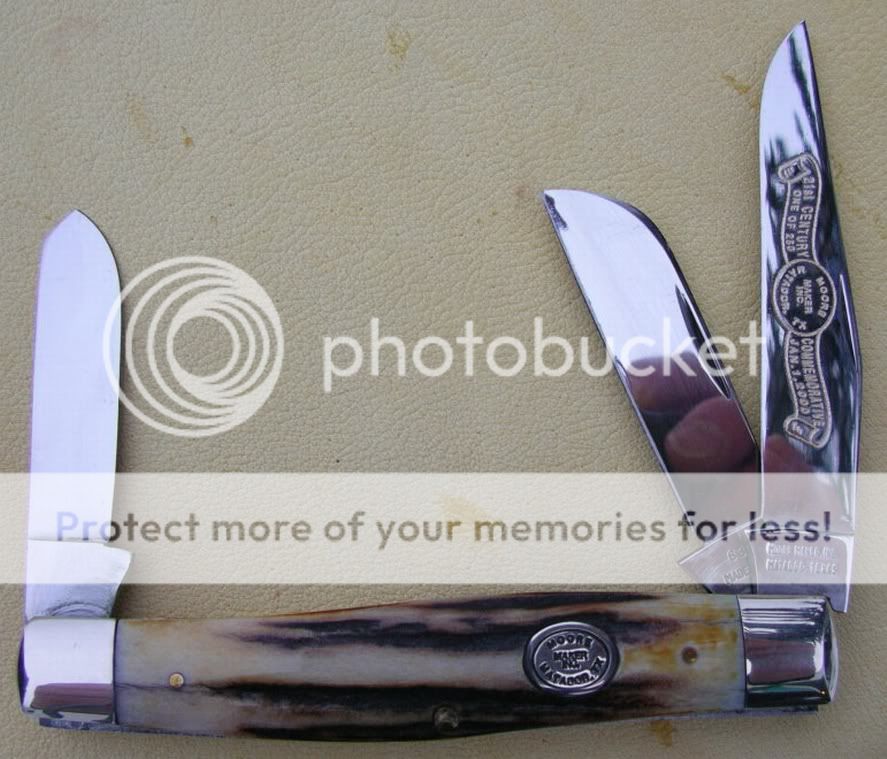

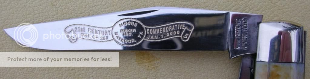

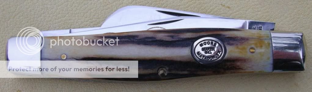

So when i saw this 4 3/8" Moore Maker Stag 2000 Commemorative Stockman for a BIN of $95, i bought it.
Sharpie marks on Sheepsfoot are from me.

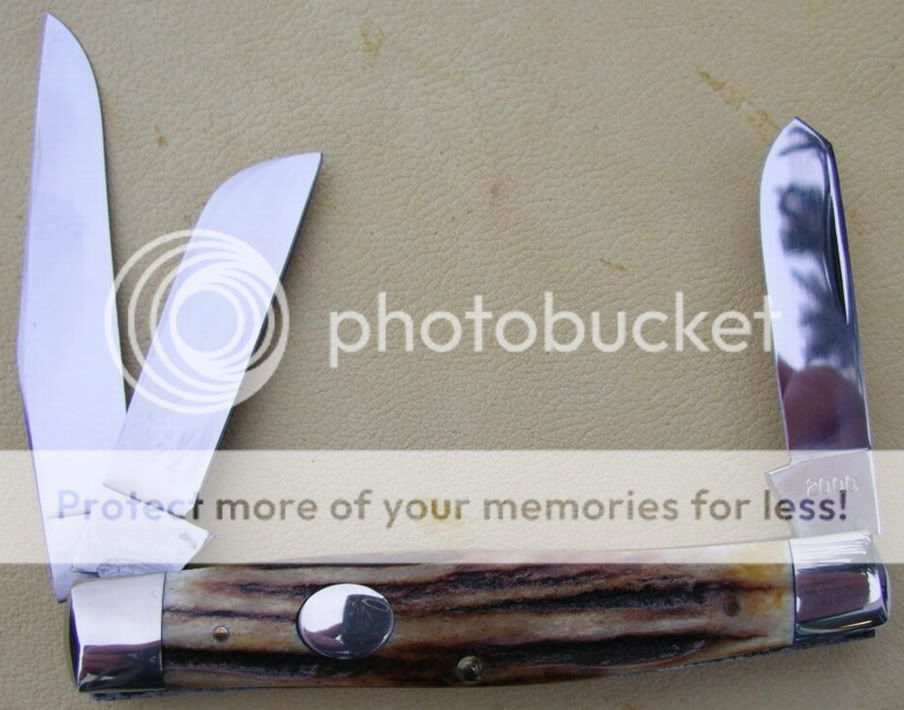

A bit difficult to show in pics, but none of the blades have an edge grind. even worse, the primary grind is very poor and the blades are still quite thick just above the non-existant edge.
the nail nick on the Master is too shallow to allow a fingernail to seat and results in a chipped nail even though spring is not overly strong.

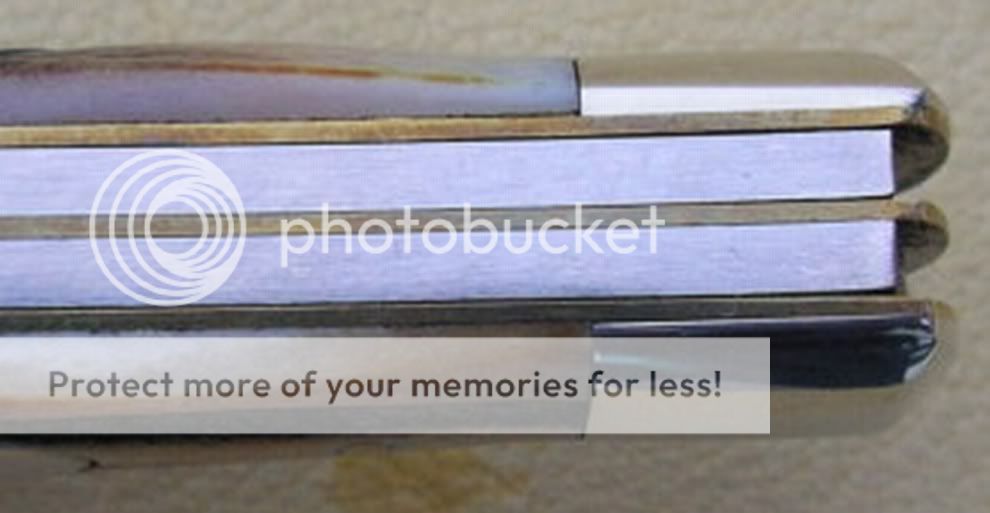

Again my pics do not show it well, but there are gaps all the way along the spring/liner interfaces and the center liner is proud of the springs enough to catch on pocket material.
also, not shown, but Spey is markedly under-bladed.
Does not look like a Queen to me. so i dug into my app. 2500 folders from a wide range of manufacturers to see what might be comparable.
Well the only folders i have with the spring/liner gaps and protruding center liner are Colonial. i only have 5, but 3 show these features.
Moore Maker's reputation is for well finished knives and is the reason they command a premium price over the manufacturer's same pattern.
What happened here ? were these 250 knives made by Queen, or did MM go elsewhere for these ?
anybody else have one ? if so how is fit and finish and blade grinds ?

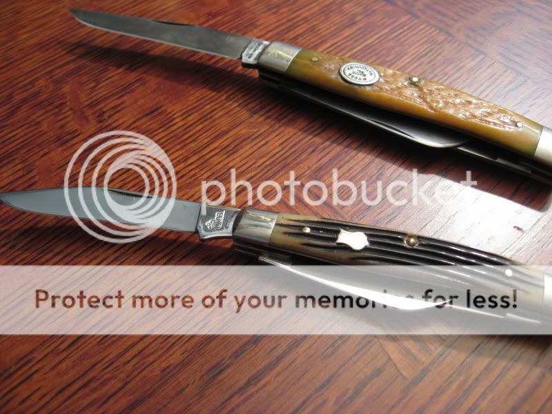

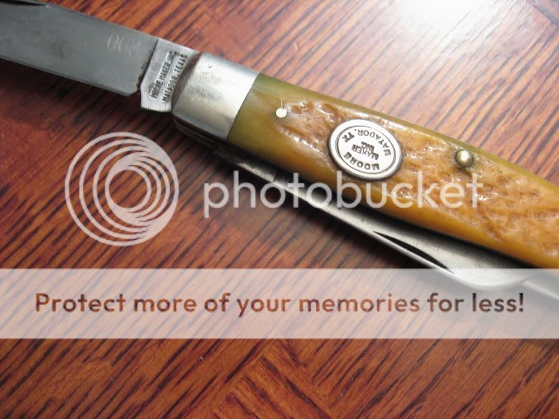

I too have a few Moore Maker stockmans. Two are 4 1/4" (stag and burnt orange), and 1, 3 7/8". I have to say, from my own experience with MM, all have very good Fit and finish. I've found the profiling of the carbon steel blades to be very nice. You are right about the nail nick on the 6302, it is very shallow. Not really the case with the other models. Ten years ago when I was looking into this make, I had a lengthy conversation with the older Moore, I guess the father. He said the stag and bone were then, made by Queen.
From my own experience, I think their well made, and part of my regular carry.
Jay
These show a few years of use wear.
Jay, thanks man; you posted another example of this knife.
is yours really 4 1/4" ? i re-measured mine and it's definitely slightly longer (at least 1/16th). i thought there was never any variation in a frame size ??
and, did yours arrive with at least semi-sharp edges ? and center liner does not stick up above springs ? and how are spine/spring meeting, level, or with blade more than 1 mm. lower than spring ? (2 mm. in mine)
As you say your knife is nice, then i guess i have one that should have been a reject, and the rest of the run was up to Queen/MM standards.
roland

Call Dave Moore at Mooremaker and talk to him personally. Ask him to warranty the knife and ask him to hand pick one for you. I gauruntee he will take care of you. I believe it is a Queen made knife. look inside and see if here is a hole where the shield would be oinned to the bolster. Yours might be piined. My 2008 has the hole and no pin.The one I sent back to him had gaps in the liners and the main blade nail nick was too shallow. I think Queen just puts a little more buff on the MM's.
I have also heard online people selling seconds. there is one that is authorized to sell them and they say they are "working knives".
The knife I got back from them the F/F is so good, it's my main EDC for most of the time.All blades are even with the backsprings when they are open,no blade play,no gaps and a great blue hue to the 1095.
the thing I like about the MM's is the nail nick on the sheepsfoot are on the main blade side. Any other stockman I owned has it on the back, and yup, it did take me 3 times to get it sharp.
