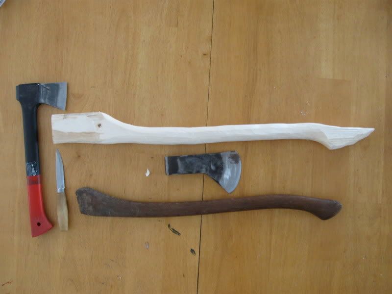

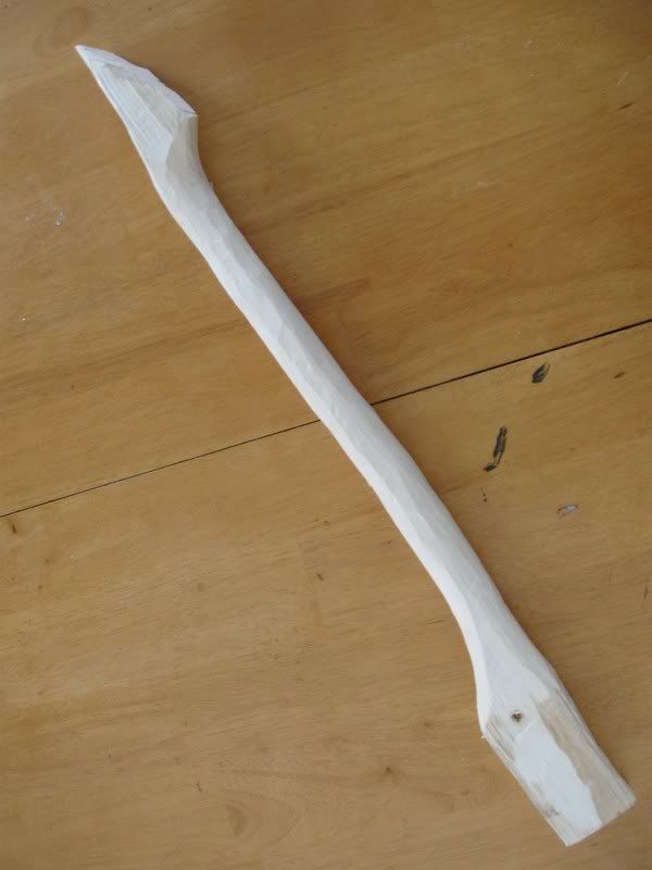

just thought i would share a couple of quick photos of an axe handle i'm working on, and outline the process i have gone through so far.
i started with about a 7" diameter maple tree, and felled it with my 3.5# Snow and Nealley axe.
i split a good sized chunk off using a beater axe and a couple of iron wedges with a sledge hammer.
i took the chunk downstairs to my shop and began hacking away with my 14" Fiskars.
then i switched over to my trusty Mora #1 with laminated blade and plain birch handle.
here is the result so far, i am pretty happy with it:

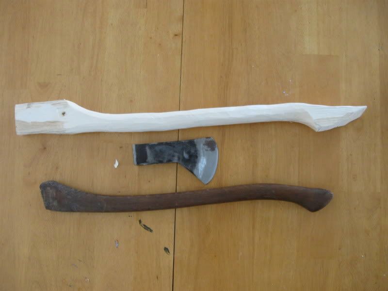

i am basing the design on this old, wonderful handle that i found in an antique shop.
the handle is going to be for a nice old Norlund that Gene (gunknifenut) gave me. he had hung a new handle on it, but there was a bit of space in the eye that allowed the head to wiggle loose, and i was looking for a new project anyways.
here is the handle with the main tools used so far...about 95% of the stock removal and shaping has been done with the Fiskars, and the remainder is with the knife.
i have some shaping and plenty of smoothing left before it will be ready to be set aside to dry, and then it can be hung and oiled up!
