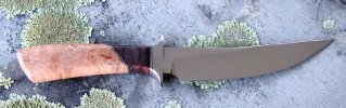

Some new work -finally!
After a long drought, these are the first knives I made since June. I bought a new grinder a month ago and got these out in between my other work load. I sent them out for sheaths this morning so I can only guess at the length. They are 11 - 11.5" with 5.5-6.5" blades. The steel is 440C and Paul boss did the HT.
All hollow ground 5/32" & 3/16" stock. The flats are mirror polish and the grinds are satin finish (hand sanded). The upswept has a stabilized Madrone Burl and Black walnut handle. The straight blade is figured Cocobolo and stabilized box elder. The drop point fighter(?) is black linen micarta. Along the way I got lots of assistance/help/advice/mentoring etc. from Jim Siska, Rene Roy, Dan Gary, R.J. Martin, Indian George and the Necka folks & others. Good equipment and patience helps, but an open attitude within the community is what brings it all together.
I have a couple others in similar styles. Brought these and some older knives to my first show yesterday and actually sold a knife! Definitely a good feeling. I will be posting these and some other new ones for sale as soon as I get the sheaths back. Enjoying this a lot and look forward to doing are as a part-time (underlined!) adventure.
Stay sharp - Bob

Bob you have some major talent going there. Those are some great knives, thanks for sharing.
Dave
I got to handle Bob's knives this past Sunday at the NCCA's show and must say he is doing some outstanding work.:D :D :D
I really like the looks of this one:
attachment.php
Great work!
-SB
