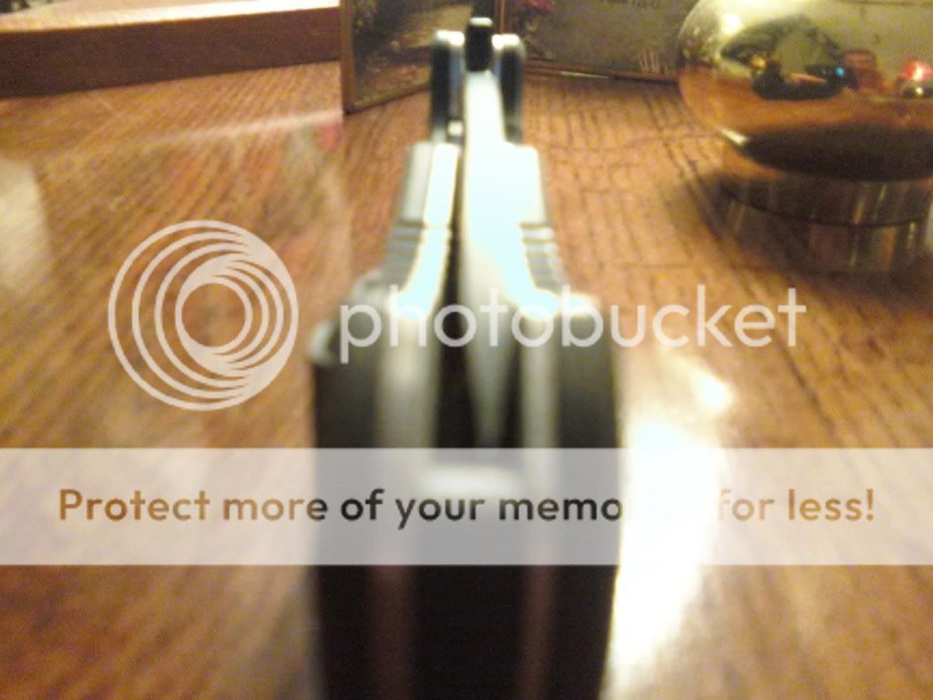

sorry for the bad pis. do yall have any ideas on how to correct this it is brand new

All kidding aside, use it for a while and let the washers break in. My CQC-10 isn't centered either and a quick search of the board told me to let it break in before trying anything. However you can try loosening the pivot, putting in a few paper shims and tightening the pivot to "train" the blade to be more centered. Let it sit for a while and remove the shims and tighten the pivot again.
Your pivot looks too loose judging from how far away from the liner scale it is. Tighten it up a bit. Theres no reason to return that without trying to straighten it out first, why the heck would anyone do that?
Send it back for a refund. No excuse for that on a brand new knife.

i just looked at my 15 ive had for almost 2 years and its the same way dont worry about it unless its rough to open and for that just break it in.
One thing worth trying then is to loosen all the screws on the knife including the pivot but don't remove them. Then once everything is loose, tighten down the pivot, and place cardboard shims on either side of the blade to center it, then tighten down all the screws and set your pivot tension back to where you want it.

This works really well. One CQC8 I had that I bought used a long time ago had a slightly off center blade. I was instructed to basically try what the above post recommends and no sooner was the blade straight and true. :thumbup:

thanks that worked its not much better but its good enough for me. it doesnt rub anymore when i open it

Glad it's center for you now. When I do get one thats a little off center I always take them completely apart and when i put them back together i put some teflon tape on the pivot screw adjust it until the blade is center and they're fine. Sometimes the pivot is a little tight for awhile but it breaks in and smooths out.

I've carried my Commander for about 9 years with the blade contacting the liner. It never really bothered me but I thought I'd try this anyway. Worked perfectly! It's actually off-center in the other direction now, but I bet with new washers and another try it would be close to perfect.
