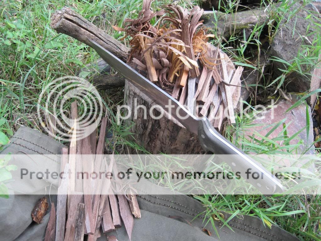

I started to split some kindling up with my One Zero knife for are soon to be fire.
It has rained a some hear lately and everything was damp. So I spilt some wood up and then made some fuzz sticks.

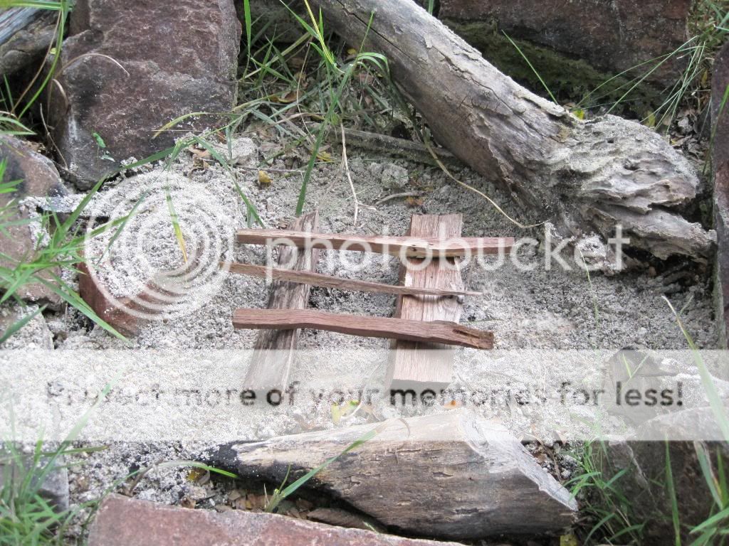

When I do my fire lays I will put down 2 peaces parallel with a 4" or 5" gap between them and they are about a 2 thick or so. Then I will put on 3 or 4 cross peaces like in this pic.
Then I will put my fuzz sticks on the cross peaces.

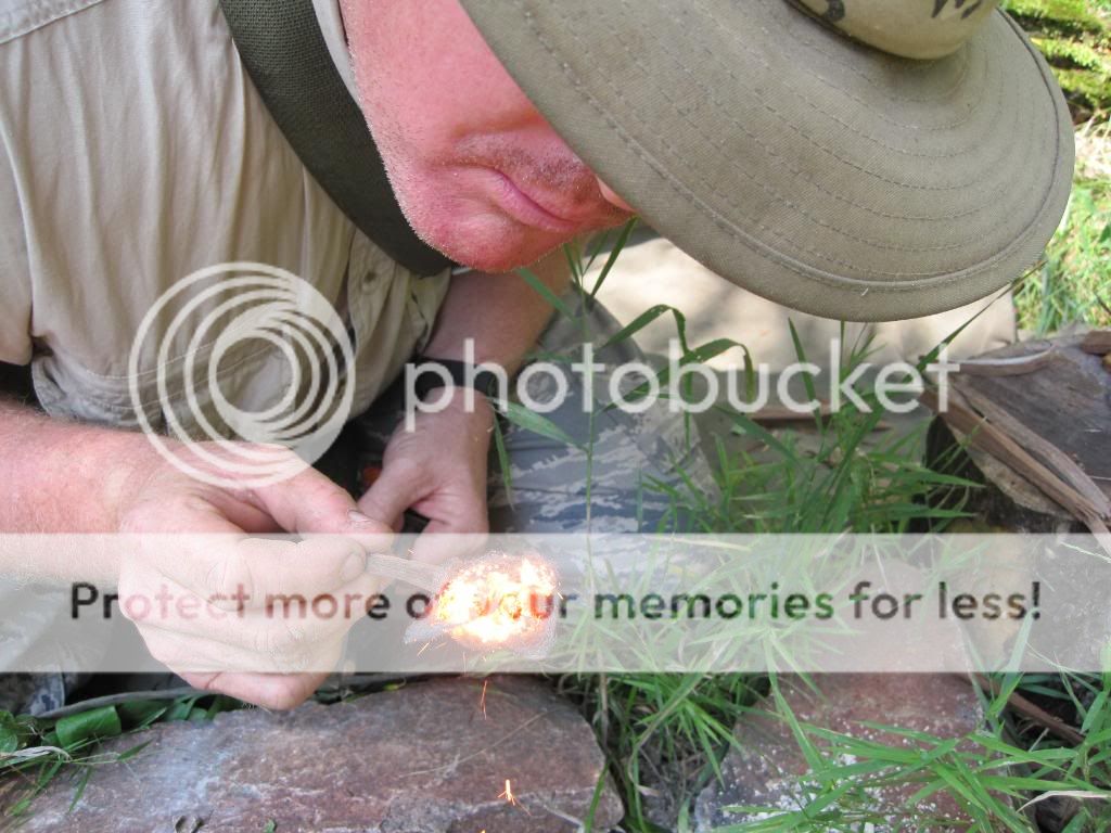

Just like with the wrapping some cotton around one of the spilt sticks I split up when I started to split wood up in the beginning for the fire i was going to have. With triple 000 steel wool if you tease it up and then lightly wrap some around a stick
and then then set the stick down and grab your firesteel and strike it so that the sparks will land on the firesteel Now once you see that it is lit grab that stick and start blowing on it and it will start to glow red hot

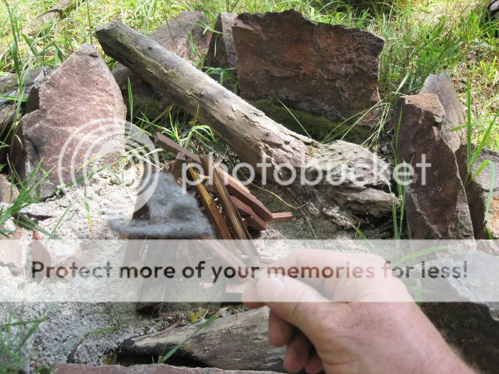

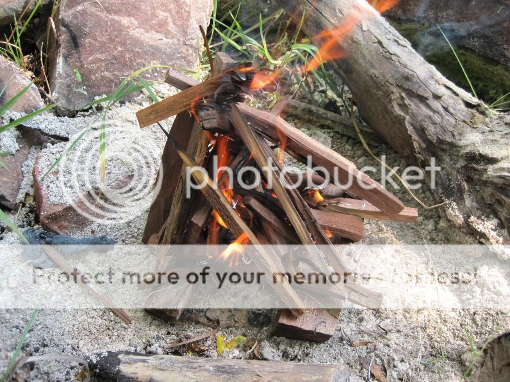

Now once you get this red hot glowing steel wool you want to get it to your fuzz sticks right away and keep blowing not real hard but trying to keep a steady flow of air on the steel wool.
Once you get to that point it really works pretty good for getting a fire started like in this pic.
Just a few more pics of my fire growing.

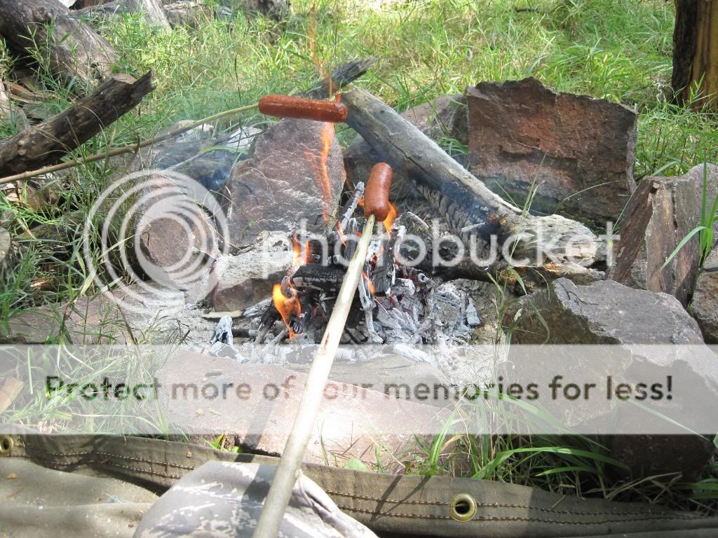

Then the pay off roasting weenies LOL

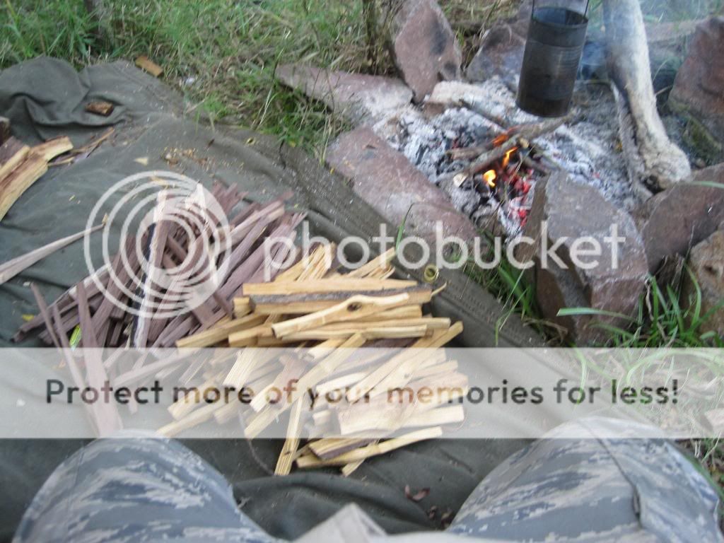

Then I split up so more wood the dark brown is Walnut and the yellow wood is mulberry for the next time I head to that campsite.

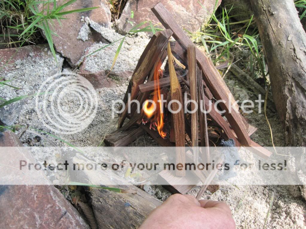

Foilist thanks, Yep no more burnt fingers for me LOL and I can put that match on one side of the fire or on the other side with ease LOL.
Like in this pic you can see that I already started the fire on the left and then moved my hand/arm over to the right side
