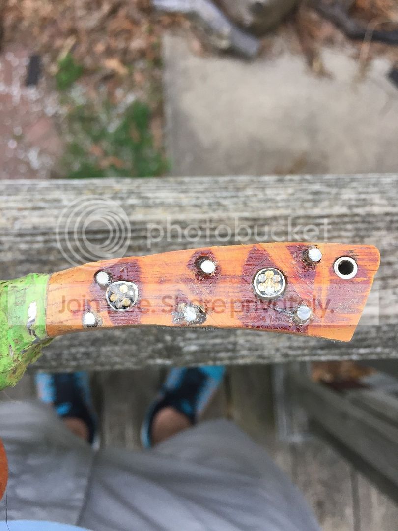

Hey guys. I posted earlier about the knife I am making from a kit. Last night I glued the scales on and inserted the pins. Today I roughed out the scales with a file and was planning on peeking the pins when I noticed how close some pins are to the edge of the handle. I will attach a picture below.
My question is: should I try pinning the pins near the edge or just sand them? I counter sunk the holes to give room for the pins to expand, but I'm worried the wood (cocobolo) may crack and expose the pins. I also need to contour the handles still, so the pins may be exposed anyway. Also, if they are exposed should I just sand it down or try to cover it with epoxy or something?

If scales have sufficient thickness /because you counter sunk the holes / and if the hole in wood is exact measurement for that pins / just sand it .
I drilled the holes bigger than the pins. I read they should be bigger to allow expansion of the metal when peening
I first drilled the holes slightly larger than the pins then counter sunk the holes so I could sand the flush with the handle. I didn't want to risk the wood cracking. Right now they are held solid with epoxy, but since I countersunk the holes there is a gap around the pins.
I'm not sure what metal it is. It isn't very hard steel, I can remove material easily from them with a file
And then you filled the countersunk holes with epoxy.......
Next time I would encourage you to put a little more forethought into your pin placement. A little bit of layout goes a long way.
Aside from that, I typically like to place pins AT LEAST a diameter away from the edge. In other words, if it's an 1/8" pin, I want at the very least an 1/8" of handle material from the edge of the handle to the pin. This may change slightly depending on handle shape, material, pin size, etc... but the last thing you want is a cracked handle because you didn't leave enough material. You also don't want to blow it out when peening.
Speaking of peening, there a few different ways to allow for material expansion, including slightly larger drills, countersinks, and tapered reamers. I prefer an appropriately sized tapered pin reamer. Don't ask the material to fill more than it needs to. It really doesn't take very much at all to get a very secure peen.
Looking at your handle, it appears that you used a larger drill bit to counter bore? I seems that you went a few sizes too big. The next size up should be plenty, especially if using epoxy as well. Use quality sharp drill bits, and make sure your drill press table is nice and square. Do a dry fit before gluing or taper reaming/counter boring. Pins should be fairly snug with no gaps, but you shouldn't have to pound the in with a hammer either.

I will probably just sand down the pins closest to the edge and peen the rest of them. If holes end up forming i will fill them with epoxy
Just sand it out and let it be what it is. There will be a "halo" around the pins from the epoxy. This isn't the end of the world, and should look fine.

Should I just sand all the pins down and not bother with peening?
Yes, at this point you can't change anything.
Peening is done when you first install the pins and the epoxy is not cured. Once hardened, you would crack the scales by peening the pins. I make a fillet knife with multiple pins. I just drill and glue as I described, and do not peen pins on handles like yours. Peening is a good procedure for single and double pins, but not really needed on most handles with more than three pins.

Ah okay. I will just sand it down and try to disguise any gaps with epoxy and saw dust. Thank you for the help, I will remember your advice for the next knife I make of if I redo the handles
