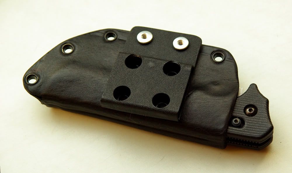

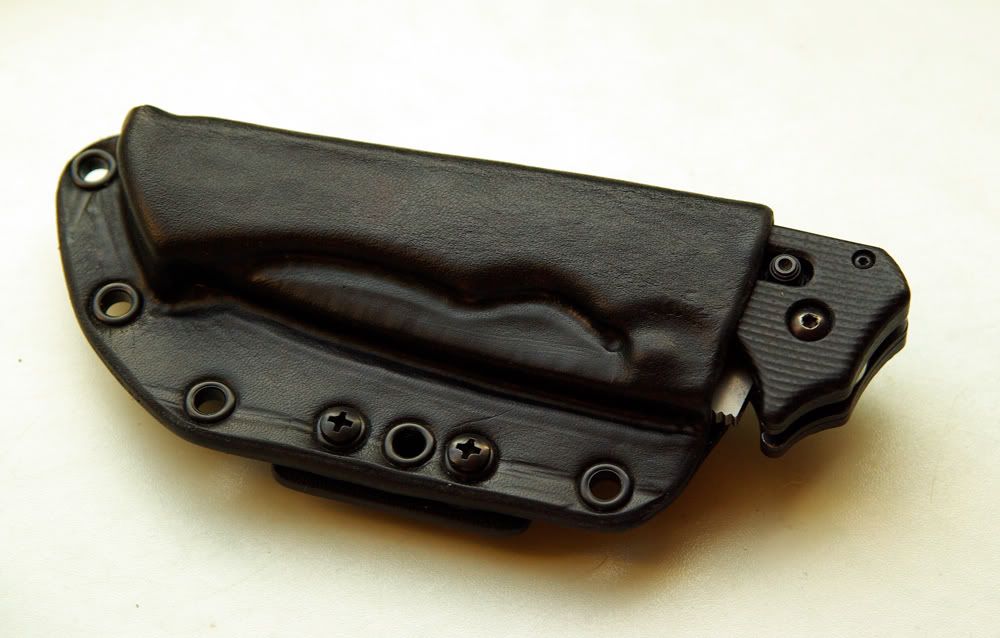

I like to show the first open top pouch I ever made for a folding knife.
It's made of halftanned leather.
The kydexloop can be fixed in horizontal, vertical and canted positions..
I'm still struggling the toolmarks, but as long as I say to myself that function comes first I don't mind at all.. :cool: (for a while)
Comments and tips are very welcome.
Martin
Looks good, nice touch with the attachment too.
Tooling marks, best to rub them smooth as you are
going through the forming stages, make sure you clip your
finger nails too :) they can add marks you might not want
to show on the leather. I form with the leather wet and keep
forming through until the leather is dry, you'll see marks but
you do need to be on top of them and keep them rubbed down.
