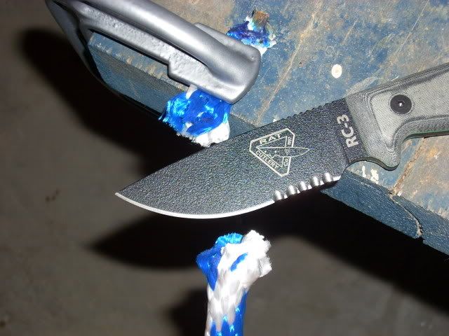

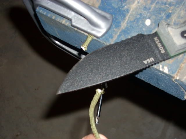

I've been meaning to compare the new vs. the old RAT serrations for a while now, and FINALLY got around to doing it! My RC3 has the new RC Serrations, my RAT3 has the older small tooth serrations (found on the RAT3, RAT5, and Model 1), and my RAT7 has the older large serrations (found on the TAK, RAT7, and RTAKII).

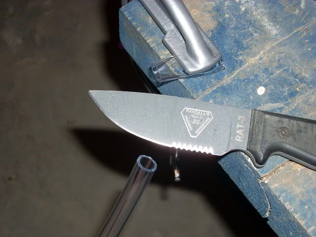

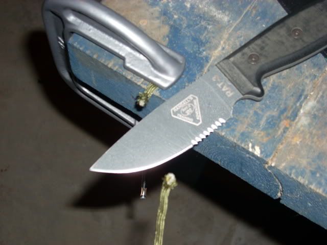

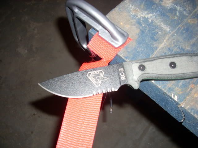

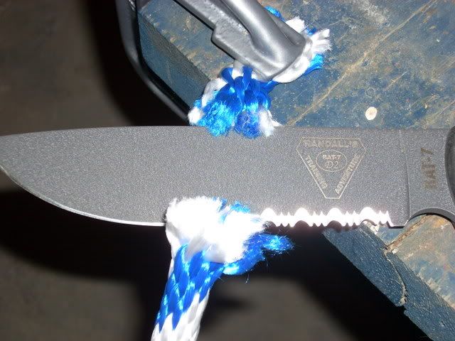

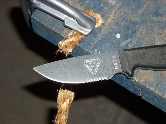

I used the RC3/RAT3/RAT7 to cut six different materials: 1.5" wide web strap, 1/4" nylon rope, 1/2" nylon rope, 1/2" manilla rope, 550 cord (parachute cord), and 1/2" vinyl tubing. One end of the material was clamped to a bench, and each cut was made about 1/2" from the clamp.
I found that my results were always in the following order (best to worst): RC3, RAT3, RAT7 - or - RAT7, RAT3, RC3. The RAT3 always held its own in the middle - whereas the RC3 and RAT7 would alternate from best to worst, depending on the material being cut.
On the Webbing, the RC3 was hands down the most efficient cutter, leaving a nice clean cut. The RAT3, being more "toothy," really frayed the web strap, but not as much as the RAT7.
The 1/4" Nylon rope showed similar results - the RC3 cutting must efficiently, with the RAT3 and RAT7 "hanging up" and cutting less efficiently.
The 1/2" Manilla rope, the results were inverse. The RAT7 was much more efficient, with its toothy serrations sawing through the rope leaving a very clean cut. The RAT3 performed very similarly to the RAT7. The RC3 still cut very well, but took more effort than the RAT7/3.
On the 1/2" Nylon rope, the RC3 and the RAT3 were basically tied, both being very efficient cutters - with the RC3 leaving a cleaner cut. The RAT7 had a tendency to hang up and left a more jagged cut.
Results were again inverse with the 1/2" Vinyl tubing - the RAT7 cut through very efficiently, followed by the RAT3, and the RC3 taking up the rear. The RAT3 left the cleanest cut.
On the 550 cord, the RC3 was the most efficient, with the RAT3 and RAT7 tending to hang up some.
Overall, my favorite of the serrations are on the RC3. They are less toothy and less prone to hang up, and only proved to be less effective on the harder materials where a "saw type" serration was more effective. For my uses, both civilian and military, I am more likely to be cutting 550 cord, webbing (seatbelts), and nylon rope - all of which the RC3 was the "winner" of in my comparison. With the new, highly effective serrations, combined with the improved fit, finish, and materials used on the RC3 - the future of RAT Cutlery is looking very bright - for Jeff, Mike, and Rowen - and for those of us that depend on RATs in our every day lives.
