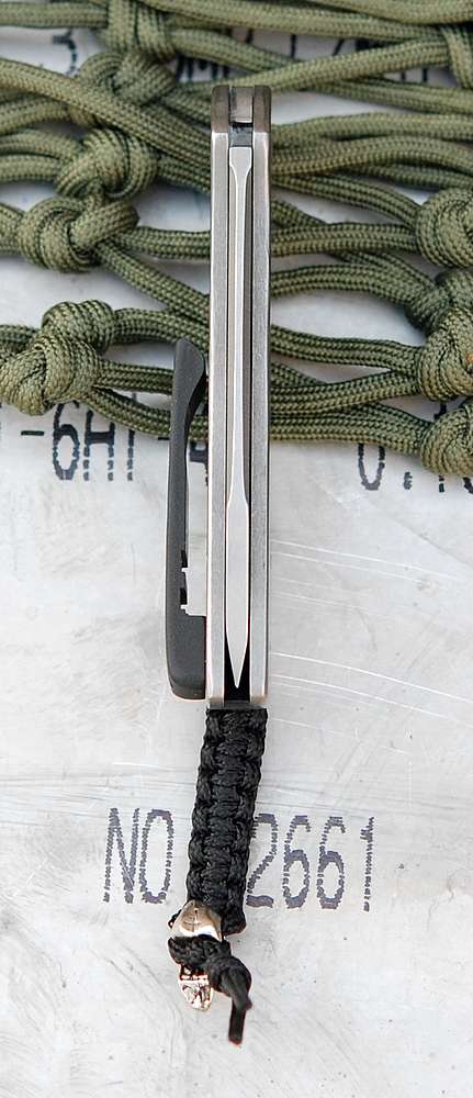

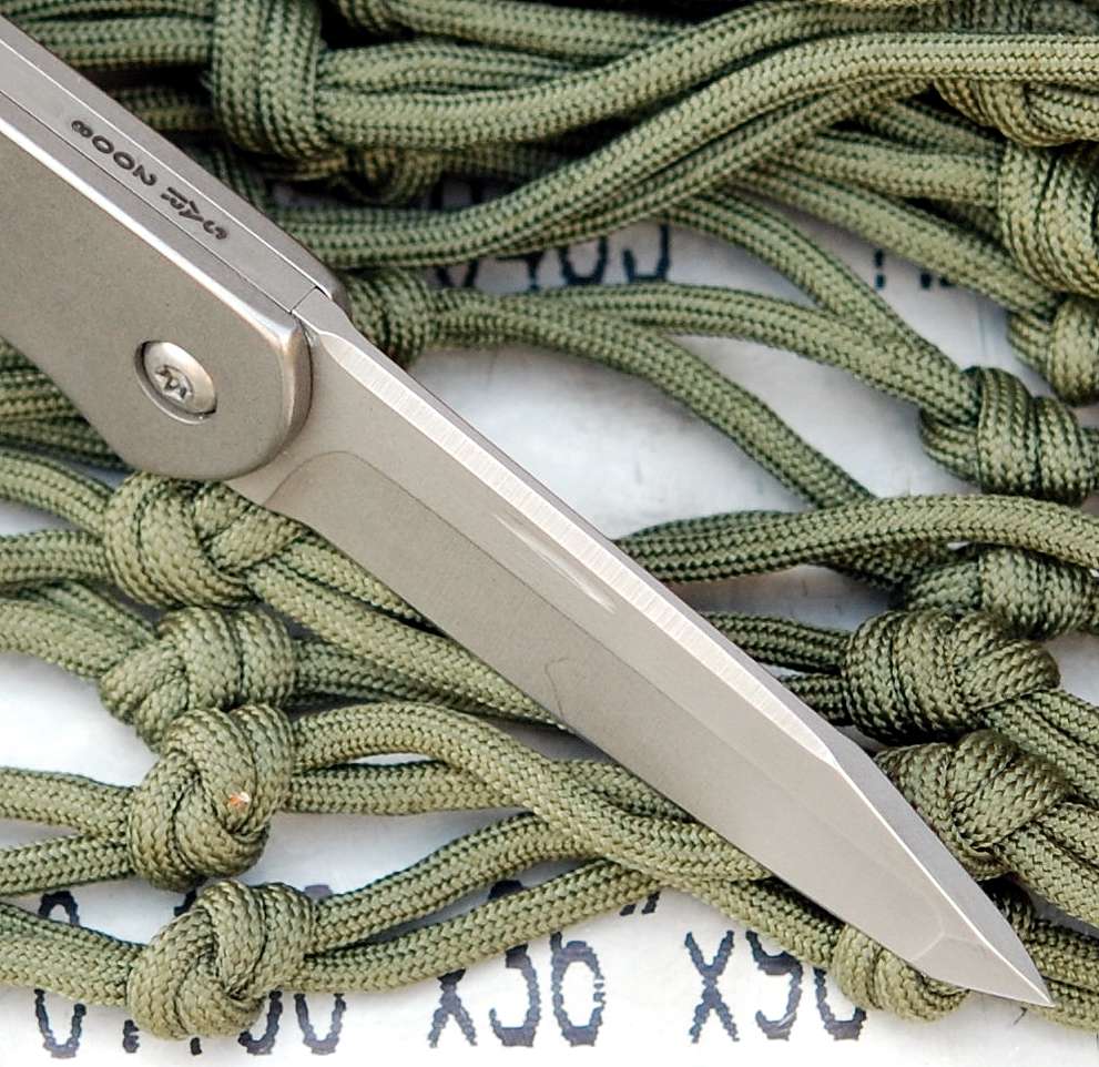

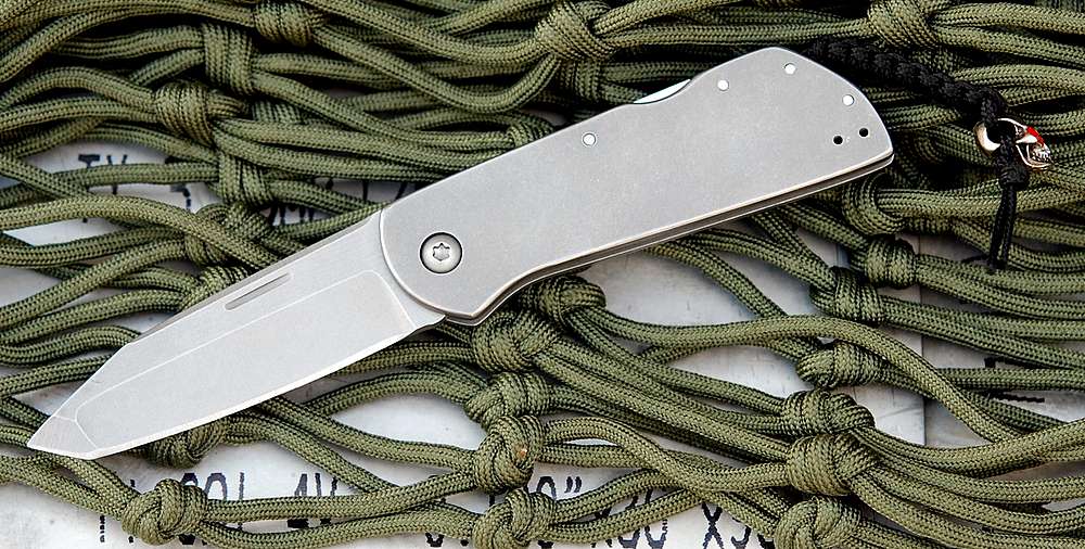

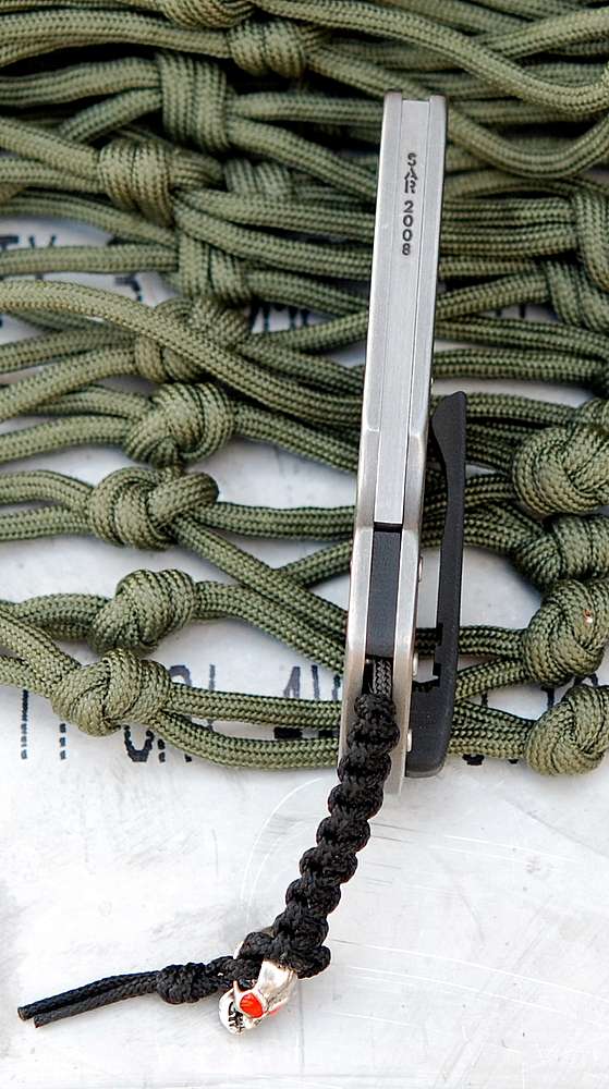

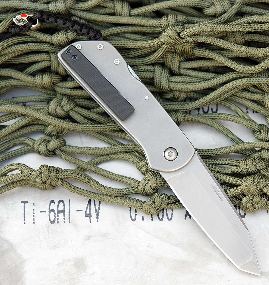

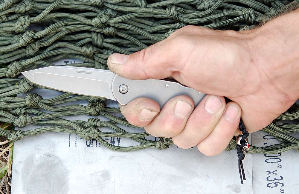

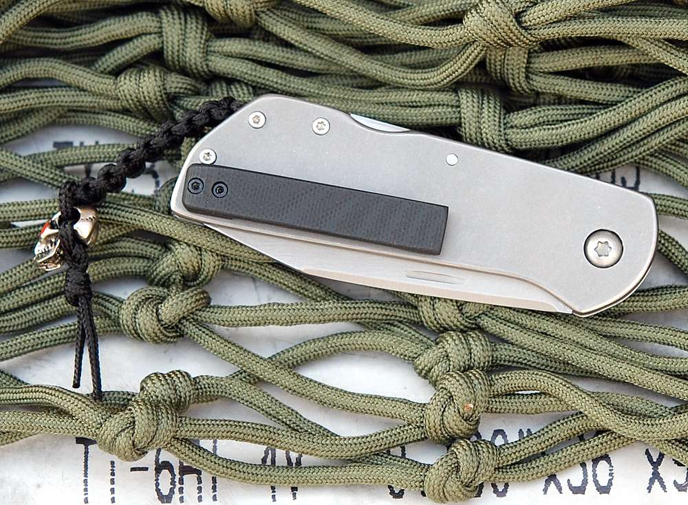

Well this sure aint it:D
My first utility/tactical lock-back
Prototype #001 from "Operation Butter-scotch"
1/8"x6 3/4" OAL with a 3" blade of cpm 154 HRc60
1/4" pivot zero play of any kind lock up is very nice
Lock-bar is cpm 154 HRc60
Frame is 6L-4v Stonewashed Ti
Back spacer and clip are black g-10 ( I am not quite happy with the clip )
Frame screw doubles as lanyard attachment.
Reversible clip as well
This one goes in my pocket for EDC operations and evaluations it has a few issue that deam it not worthy of sale.
I am not even close to finished with this design, I can go any direction now for frame material etc.
Thanks
Spencer
Spencer, that is a great little knife!! I WOULD buy one. I REALLY< REALLY like that. Great job!!
It sure looks like a proto! :D
Knowing the unique nature of your designs, you will take this design to amazing places! :thumbup:
Stout looking little sucker!!! That point looks like it could take a good bit of abuse!
Missed you at SOS.
Mike and Manuela
I like the clip. Put a disc-opener on the blade and make it one handed.:thumbup:
Heck ya , I like it bud. But you already knew that right ? :)
I will definitely be down for one , plain jane is good , as it is gonna see a lot of use.
You told me you were gonna do it and you sure as heck brought it , well done.
Spencer, Your work is always top notch but lock-backs are out dated technology. Keep your skilled eyes on the future.
Considering the disk just waiting for a few to come in to try.
The clip does need some work IMO, just seems a tad bit out of place.
Rides nice and low in the pocket, maybe it just needs to be a bit smaller.

I like it! Lockback is fine with me, but since someone has spoken up for the other options, I'd like a thumb stud. I like the clip, but agree that it could be smaller- and/or shaped to complement the knife more.

I like the blade profile a lot - just enough belly to make it a great cutter. I don't like the clip, and I also would like clips to be screwed directly on the butt, on the spacer. That would make it even more low-profile and also would make it easier to convert to left carry.
I also think this needs a disk opener.

Spencer, very nice, I would be interested in a knife like this! All is this is personal preference but I like the nail nick vs a disc or stud. A hole would be good but might detract from the look, not sure. Though one hand opening is always nice so is a knife that doesn't get stuck in your pocket, I find a stud and some discs do this often, no worries with the nail nick or a hole.
Great knife, I really like the look and design.
