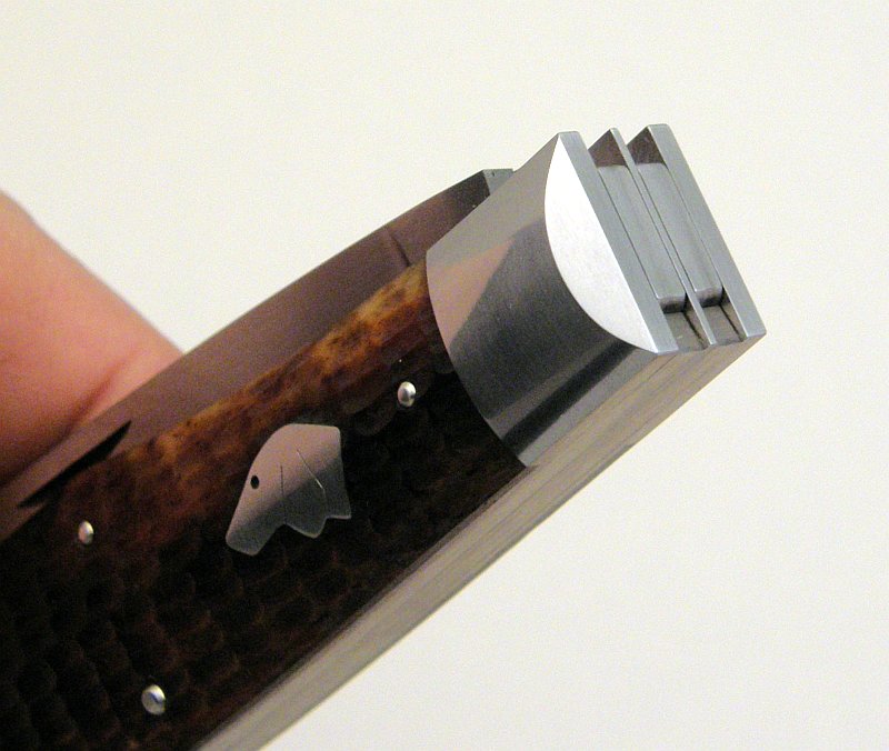

Did they make a flush joint on the GEC? Also, I know you may not have access to the Remington now, but on the GEC, what is the blade thickness of the edge(just above the bevel)? I have handled a few of GEC's knives. On the ones that I have seen, they do a good job on the grinds and overall mechanics of their knives.

Did they make a flush joint on the GEC? Also, I know you may not have access to the Remington now, but on the GEC, what is the blade thickness of the edge(just above the bevel)?.
Knifehead - I took a picture of the two together of the area that I think you are asking about. Let me know if this is what you were looking for;

The GEC and Bose Dogshead pictured both have flush joints that don't include the spring. The Remington includes the spring. From a makers standpoint, that is a 9.5 sphincter phactor. :D That is impressive that GEC takes the knife that far. It's an advanced feature on slip joints. They do it because they can...the only real advantage being that it minimizes lint catches.
