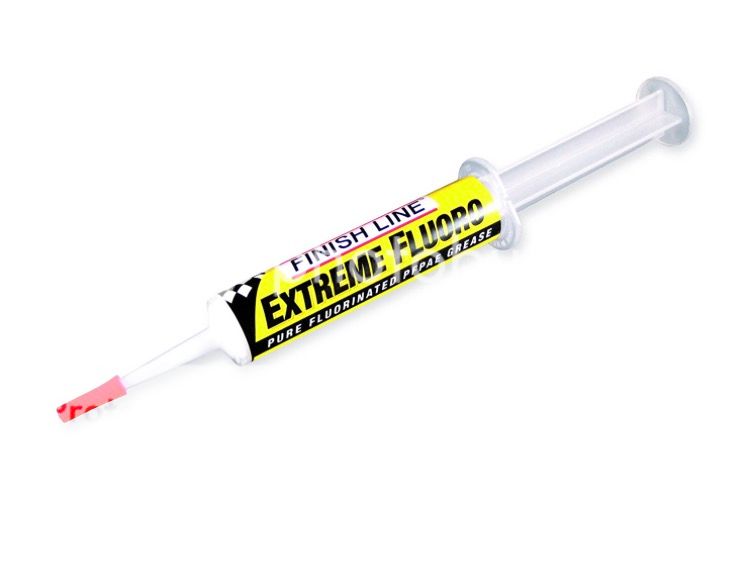

Sorry guys I'm sure there is a thread on this, feel free to link me to it so I can give everyone's options a fair chance but ..
I've owned my L21 for about a week now and I saw ApostleP use this..rather than the grease CRK provides. I have no doubts it's better. But me being who Iam..only want "the best for the best" kind of deal? So is there anything BETTER than what he uses?
Ps
Please don't suggest nano oil, I've heard nothing but bad things when used on the Sebenza because of the viscosity being so thin, it ends up leaking onto the lock bar and just ends up making a mess of your knife. I need something thick that will last in these perforated washers.
Pic posted below
[URL=http://s86.photobucket.com/user/Aquaholicc/media/IMG_8525_zpsdrxbnlrx.jpeg.html][/URL]
CRK grease with a SINGLE DROP of 85w Nano Oil on each washer. Assemble the knife, open and close the blade a few times, and you're golden. The oil helps prevent the grease from drying out and provides for amazing lubrication without being runny.
Not only does this make my Sebenzas smoother than ever - it lasts an insanely long time. My daily driver Large 21 hasn't been cleaned / lubed in months, and it still glides open like butter.
Hmm you think the nano oil trick will work with the finish line stuff? I think my CRK grease is about out. Either that or I've got to shake that little tube like a mother..

I tried that, Reeve grease is better. Maybe you could mix it with a little oil but meh.
reeves grease is best. there are alternative brands for it tho. finish line grease does fine as well but its not better than the crk stuff.
Welp, way to ruin my Friday night fellas lol. I'll just see what I can scavenge from the CRK tube. The knife was made 2016 and the original owner said he didn't even cut anything with the blade only rode in his pocket a couples days (which I believe). Plus when I received the knife I didn't look like he ever serviced it..so there has to be some grease hiding away in the tube.
Interesting, my experience with CRK's grease has been less than stellar. I found it very watery and when it dried the action became noticeably worse (it dried within a day or two, tried it multiple times before giving up and buying some Finish Line). Finish line on the other hand had no excess water and did not dry out after only a day or two. I hadn't taken my Inkosi apart for 3 months at one point and it was still free and smooth. Maybe I just got a bad tube of the CRK grease, but Finish Line is excellent.
If you kneed the tube the watery substance mixes with the grease. It's totally normal.
This is exactly my problem. I would go to lube my bushing and I got nothing but watery crap lol. I guess I'll just kneed the tube like playdough.
It's worth a shot. Nano Oil is amazing stuff. I'm sure it'll thin out that finish line grease and add a good deal of lubrication.
