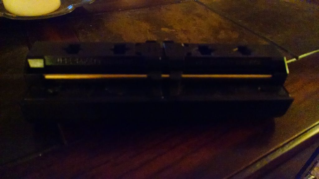

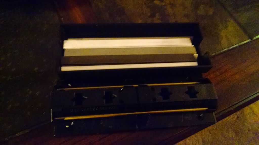

On storage, I put all my rods in the lid and the sharpener base snaps into the lid on top. It's not as compact but they are all together.
Added pics, thought it might help explain what I do. I can't believe I'm the only one who does this!
I have all four grits from diamond to uf. Ialso keep them in the lid, but unlike you I wrap them with a thin paper tissue to prevent them from touching each other
