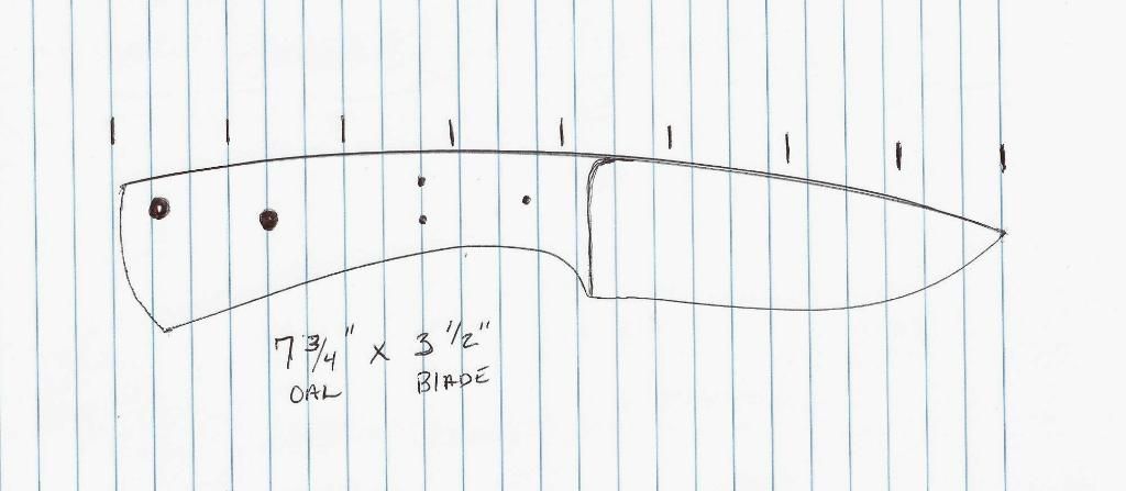

So I received an email from a guy that is looking for a skinner/Hunter the other day. Ive never made one and don't get to skin out much except for squirrel! Anyway, I don't really take orders but I want to give this style a shot. He is a custom collector so he has knives by all the greats and it is kind of intimidating really. He saw that Alans Nessie I posted on the main exchange and liked the style so....here we go. I have been thinking about the design for a couple of days and have come up with something I think might work. All you more experienced skinners speak up. I would like your feedback. I wanted something that had a curved butt, slimmer blade, and of course alot of belly. I think a guard would be great but I don't make them so I kind of added one the best I could. Oh, and he is trading me this kick ass custom slipjoint for it! Check out that handle! Be honest, I need some help
Here it is. I added a choil in front of the guard and rounded the front spine for detailed work. Its different but comfy as hell. What ya think?
