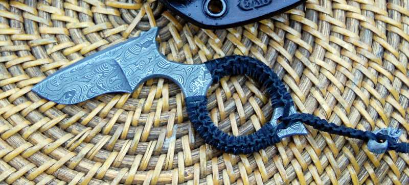

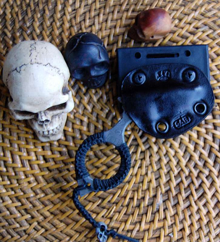

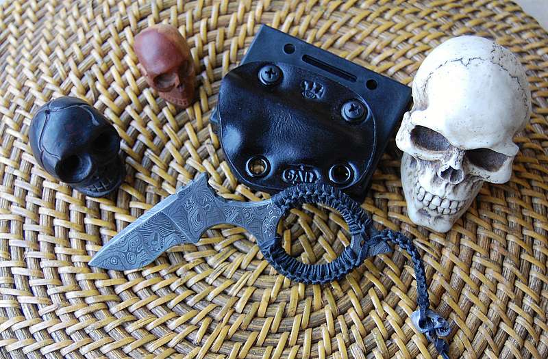

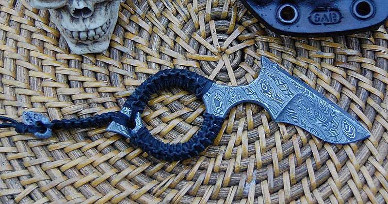

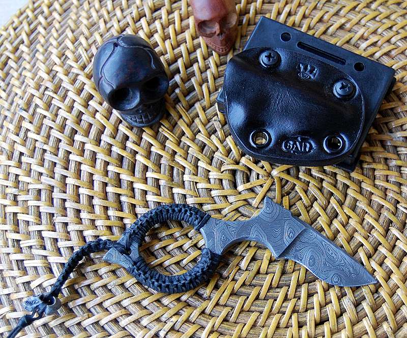

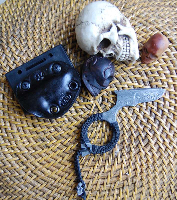

Steel is really nice Stainless by Chad Nichols it called constitution pattern
All feature a recurved blade and range from 1 1/2" the long one is 3.5"
Sheath is felt lined leather over kydex set up for MALICE or Tec-Lok will not scratch the knife period.
Premium vegetable tanned Kangaroo leather for the wrap and lanyard
Etched pewter Mean skull
I received my SARclops stamp but had already HT'ed so I decided to stamp the leather.
This is my first for SS damascus, it gave me a little challenge when I tried to etch it but I finally got it right...well it looks good to me.
