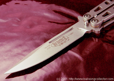

My preliminary review of Tachyon (and remember, I've only had this thing for a few days so I'm not going to reach any earth-shattering conclusions just yet. So, please don't go asking stupid questions like "Is this thing gonna last forever?" I don't know. I've only had it for a few days.).
So, what took so long to get the review done? Well, all totalled including three wall paper images, it's almost twenty-five megabytes of material.
Anyway, here's a little something to peak your interest
The rest is on http://www.balisongcollector.com
