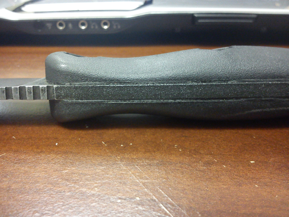

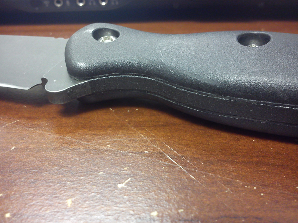

First up was the creation of some liners. The one Moose was toting around was pretty slick, and a big part of that came down to the liners he had on his. The handles on the shorts are very, very comfortable, but they do feel small. The addition of two 1mm liners on either side changed that dramatically, giving it the "big knife feel" you get from the regular sized Beckers.

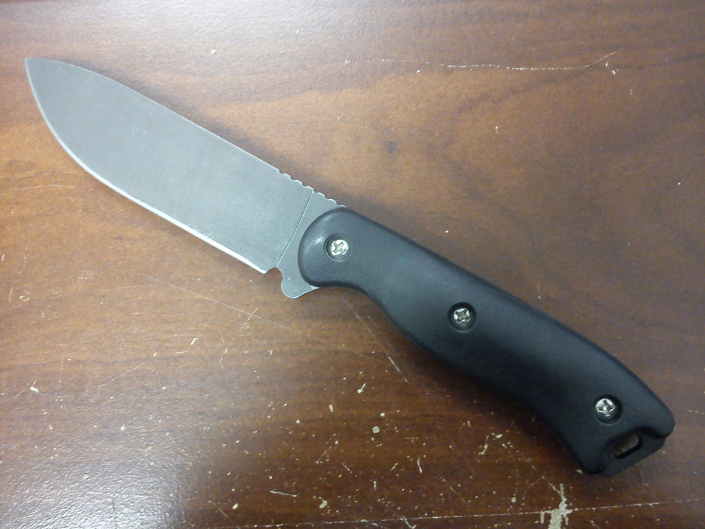

Next order of business was to strip the coating. I didn't want to remove all of it, just the stuff from the blade area, so I followed Oregon Fal'ers method shown here:
http://www.bladeforums.com/forums/s...de-while-leaving-the-coating-under-the-scales
I used Jasco from a can, which ended up being a gel. It took awhile, about two hours, but I finally got the coating off. One thing to note, I couldn't find the 3M Lacquer tape, so I went with electrical tape, and that seemed to work nicely. I also suspended the knife blade down while it was doing it's work so that the gel couldn't run up and get into the handle area.
During some sharpening shenanigans at Ethan's last week, my 16 got the tip rounded off a bit, so I spent a good bit of time on the grinder getting the tip back. Pointy helped with that immensely. I also tried to square up the spine. That needed some more work as well, so when I got home I took a stone to it to make it nice and square. It should work great now for a ferro rod, or for making fine shavings.
Once I had the coating gone, it took three dunks in some diluted PCB Etchant from Radio Shack to give it a nice dark patina. Dunk in warm etchant dilution for about 5-10 minutes, take it out and wash it, dry it, then set back in etchant solution. The ratio was about 1 part etchant to 4 parts water.
Finally, after all that was said and done, I took some stainless steel pan head phillips screws I had and cut them down to size with a dremel. Still need to get some stainless nuts, but that won't be too difficult to manage. Someone had posted the screw sizes up here but had mistakenly said they were 6-32, and they are actually 8-32. Anyways, here is the end result of all that business.
Without the coating the jimping is much more aggressive, and grips the hand very nicely. The wider handle makes it feel much better in the hand though, and might be a viable option for those that feel the index finger area to be too shallow. I hope to get it out and dirty it up nicely here in the next few days, so look for more pics if I get any at that point, and if you don't already have one of these, now is the time to go and get one.

The etchant patina will protect the blade from rust, just as any patina will do. As far as permanence, hopefully this will last, but ultimately it is more of a protectant until the blade develops it's own patina through use. The grind lines in the blade will trap some of the patina in them and protect longer though, so in that way it should last a good bit. Add to that the fact that the blade was stonewashed and it should work out pretty well. The etchant dip might need to be repeated several more times to make something tougher though. Not really sure.

The retaining straps on the sheath will stretch to fit around the handles with liners.

That PCB Etchant gave a beautiful matte charcoal/gray finish that makes the FFG BK-16 look as good as it is useful.
And the liners do make a difference for those of the bear-sized paw, like myself. Personally, I find the stock grip thickness great, but with liners it's just about perfect for my hand or if you want the "big knife feel".

If you like the FFG I'll take any saber ground ones you have haha. But 2 hours for the stripper to work? I used some spray on stripper and I only left that on for like 30 seconds before becoming impatient and scraping it off...Worked fine .
