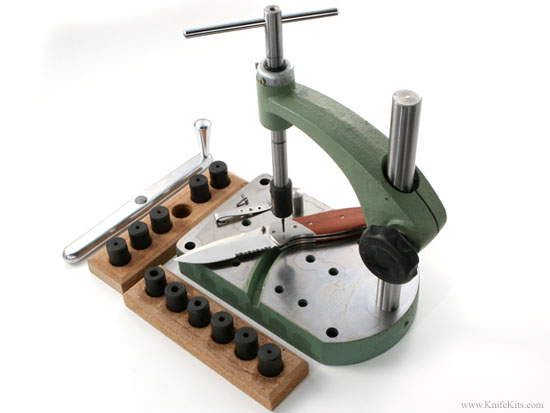

im looking at picking one of these up:
http://www.knifekits.com/vcom/product_info.php?cPath=49_211_118&products_id=584
http://www.knifekits.com/vcom/product_info.php?cPath=49_211_121&products_id=592
mainly for repositioning clips. im leaning toward the one with the press, since one of my concerns is keeping the holes straight. im certain it is way more tool than i need, but don't mind dropping $100 if it will do a decent job.
if the cheaper handle-only one would work as well, then of course i would opt for that.
i dont have a drill press or anything similar that i could substitute should anyone suggest i get only the bits.
thx!

i had linked to the same one in my first post, corrected now.
the more expensive one is still manual. im guessing it is fairly labor intensive, but figure for the amount i would be using it, that is fine.
Yes now I see what you are talking about. That is another story altogether and I'm sure it will work just fine because it will make it very hard to break taps for sure. Thats a fine set up no doubt about it. Its a blessing to many that need it too because not everyone has the $600 plus for a tapmatic or the need to even spend what they are used. Every now and again you find one on ebay for 100 bucks if you are lucky but the problem is that everyone and their brother is looking at it too ready to snipe your bargain. :mad:
I'd have bought that if I had known about it and probably would have skipped purchasing the tapmatic at all since that will do it albeit a little slower. I notice others see the value. Its out of stock currently. Too bad I wouldn't mind having one myself as a back up.
STR
thx!!
ill give them a call and see if they plan on having them in stock any time soon.
Pretty neat tool! But my tapping problems always happened with getting the hole drilled true - for which you really need a drill press. And if you have a drill press, then you don't need that tapping tool.
