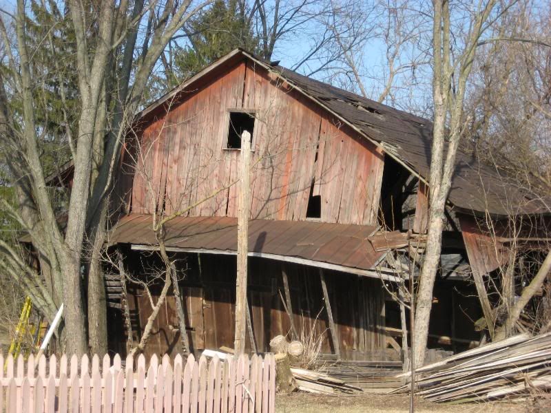

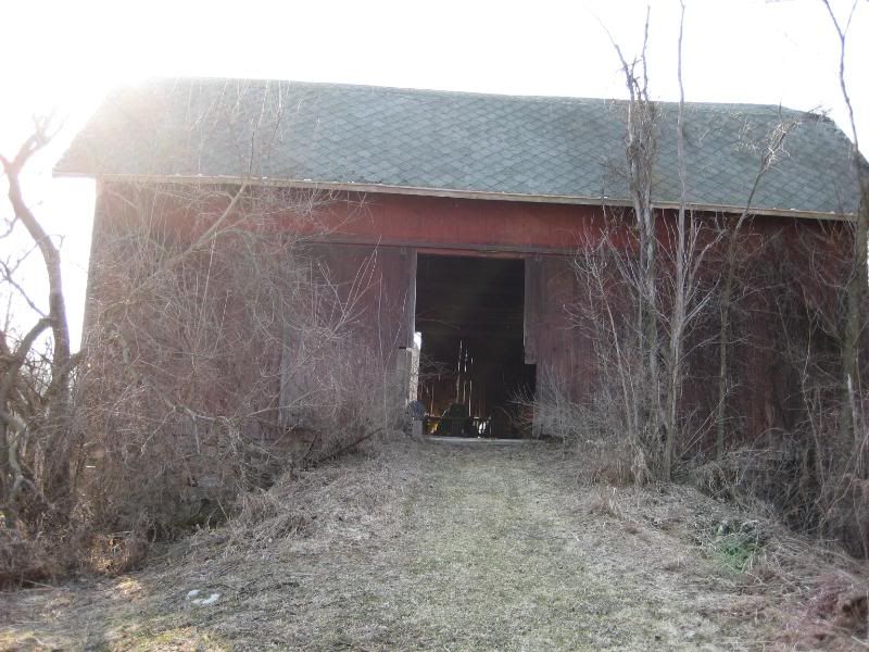

I have three barns on my property. All were built with block and tackle and axe hewn logs and tounge and groove. Two of the three are in good shape but when I bought the property 13 years ago this barn was already listing to port..
so my neighbor and I started the slow process of tearing her down. We are trying to preserve the wood and most definate the beams as they are made of solid maple or oak..massive trees cut out of Michigans forestland circa 1898 ( that is the date of the barn branded into a piece of wood in the other barn)
I will keep some of this wood but sell others...since I am outta work this may be a source of income for my haldol and lexapro...

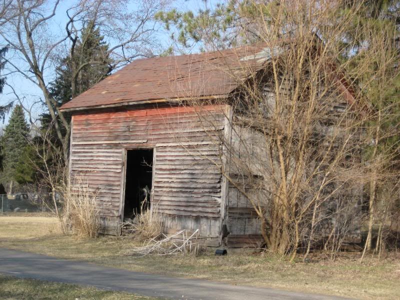

anyway ..here are the other two barns on my property..

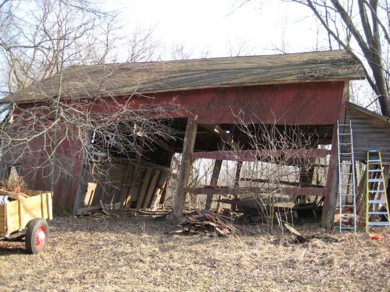

the feed barn..

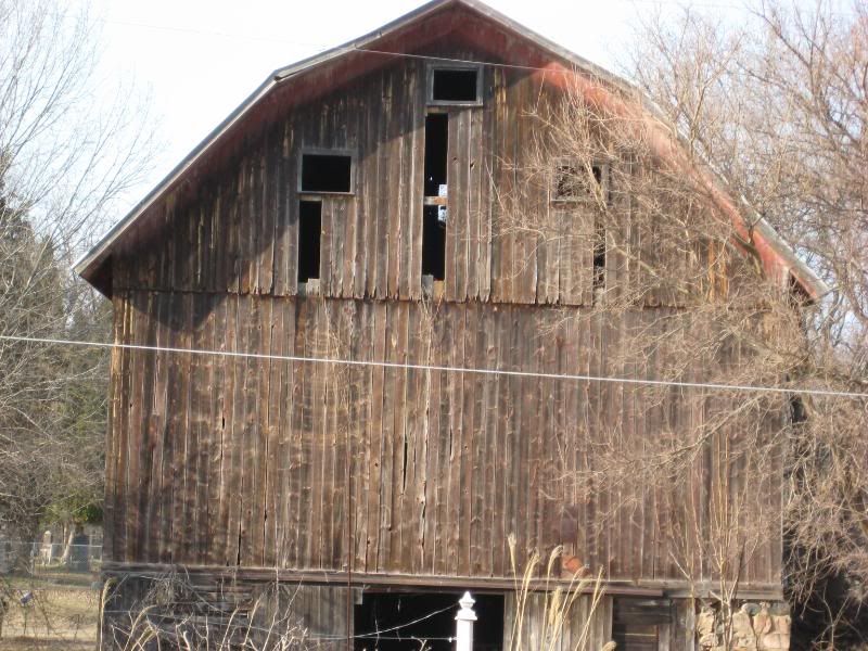

and the big barn..( I know I should fix the board missing but that is like 100ft in the air...:eek:
might want to take the roof off first, so that it doesn't collapse on your head. Looks a little dangerous to me.

exactly what I was thinking. And we cannot tear the roof down first unfortunately..the structure is too unstable to get on the roof. We are carefully removing the lumber. Then we are going to cut a few crucial beams with a chainsaw and I am hoping to pull it down with my tractor and a chain.
Yeah, that's sketchy stuff- a fella could get hurt if he's not careful. We tore down an old Civil War era barn on our property a couple years ago- and it was tricky business. It was sad, but it had to be done. We pulled ours down with the tractor- that's definitely the way to do it. Just toss chains around the uprights and heave-ho! Do it a few times, even after the big collapse, until nothing is standing up anymore. Then work from the top of the pile down. Don't get inside a heap of that mess under any circumstances- my brother found that out the hard way- at one point, he found himself supporting a nice big section of the roof on his back- he's lucky he didn't get squished. He got beat up pretty good- but no permanent damage.
If you need to get at a certain piece, hook a chain up and pull it out with the tractor- a tractor is awesome for that type of work.
Have fun and stay safe!

Not to be overly picky, but in that first pic the barn appears to be listing to starboard. :D

That old barn wood is worth a few bucks to the right people and you look to be going about it the right way.Use cable,and a long one at that when you hook the tractor to it,so your far away from the pile when it comes down.Before you get rid of it all,make sure you keep enough to repair what needs to be on the big barn.Is that a slate roof on the big barn?

I'm jealous of the big barn BTW;)

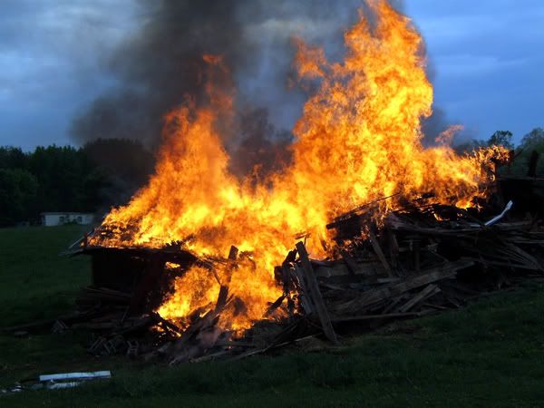

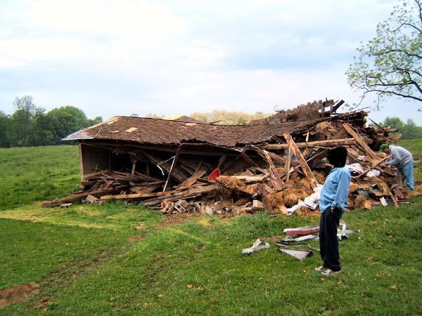

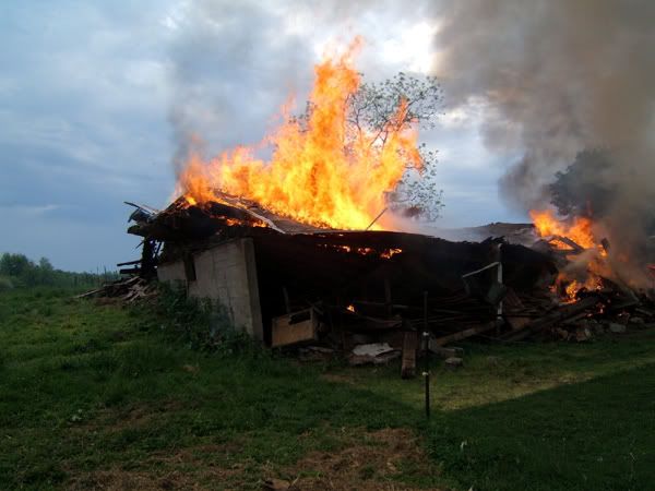

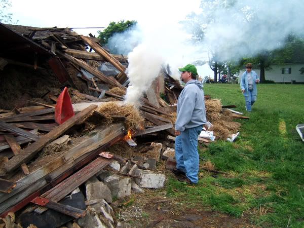

This was the way we took one down a few years ago. First we cut all the major interior supports and then pulled them out. With just a bit of pressure we then collapsed it on itself. an application of flame took care of the rest...
Hell that barn ain't going to fall over, I've been a thousand foot in the air on a lot shaker things than that.. Get up there and start from the top and take her down.......YMMV..
