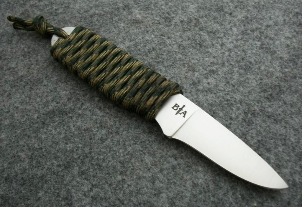

WELL WE DO ALOT OF CRAZY THINGS HERE IN THE COUNTRY,HUNTING ,FISHING WE PROCESS ALOT OF DIFFRENT GAME,WELL WE NOODLE AND JUG FOR HARDSHELL TURTLE IN THE CREEKS & POND AROUND HERE,SO WE NEEDED A KNIFE HERE AT THE SHOP TO CUT THERE TOUGH SKIN AND CUT THEM FROM THERE SHELL,SO I CAME UP WITH THIS LITTLE FELLA,IT WAS MY FIRST CORD WRAP HANDLE,SO DONT LAUGH!!HEHEHEE , I WANTED A SHORT STOUT BLADE BECAUSE THATS WHAT IS NEEDED FOR THE PROCEDURE,SO I CAME UP WITH THIS ,I FIGURE THE CORD WRAP WILL HELP WITH NOT MAKING THE KNIFE SLIPPERY WHILE IN USE AND COMFY IN THE HAND WHILE MAKING PRECISE CUTS HERE IT IS, WE HAVE 3 IN THE DRUM ,SO TOMMOROW THIS WILL GET IT FIRST WORK OUT MAYBE IF I REMEMBER TO TAKE THE CAMERA ILL GET SOME IN USE PICS
ALDO'S 5/32" 1095
CORD WRAPPED
FLAT GROUND
6 1/2"OAL WITH A 2 1/2" BLADE
Sweet! I love that mark too. Is that new or old?
Damn guys that is my old mark, i liked it too. But i hate stamping on my blades you can make one foul move and have to regrind the knife, my machine etched deep
Thats why you should force patina everything! It just blends in :)
