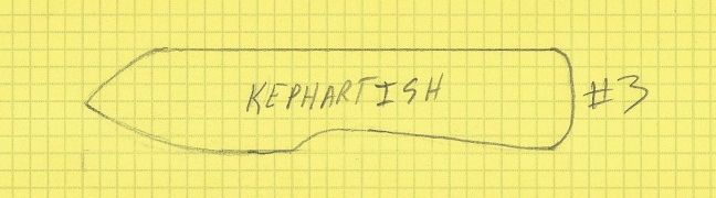

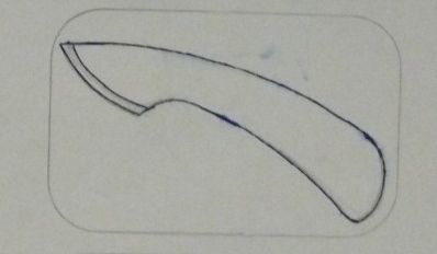

Here are the 3 tin knives that were voted for to be made,Now we need your vote to see which one will make it to production! Here they are in order please vote for the one u like the best "1" vote only please by each member.This poll will end on Friday Febuary 10, 2012
Many Thanks to Everyone for your awsome designs.
THESE KNIVES WILL BE MADE FROM 3/32" OR 1/8" STEEL WHICH EVER CHRIS CAN FIND A SUPPLIER FOR.
#1-
#2
#3

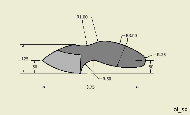

Hey guys, please post if you would prefer 1/8" or 3/32". Im thinking about trying out water jet. I can order a large sheet of steel and have a ton less waste. Im finding out about the cost now but if its affordable I might go that route. They can do the profiling and do the holes or skeletonizing even. The cost of getting it done might be more, but it will save time and Ill get more knives out of a single sheet or bar of steel. That way all I have to do is heat treat and grind the blade and they will all be the exact same.
I thought I'd post a couple pics in hand and in the tin for size reference to help everyone get a perspective on how much (or how little) cutting edge you get with my design. Some people want more blade, so one of the other designs might make a better choice for you. I always like to see "In Hand" pics to get an idea for size because I have XXL glove hands and finding handles big enough for me is tough. I also drew on some thin twine/wire wrapping to get an idea of how that might look too.
Good Luck fellas and I want one of whatever model get's selected by everyone here...I'd be stoked with ANY of 'em!!!!
All the Best,
Stump

#3 in 3/32"....*Big Paw Syndrome*.
Love the other designs, too, but I have *B.P.S.*

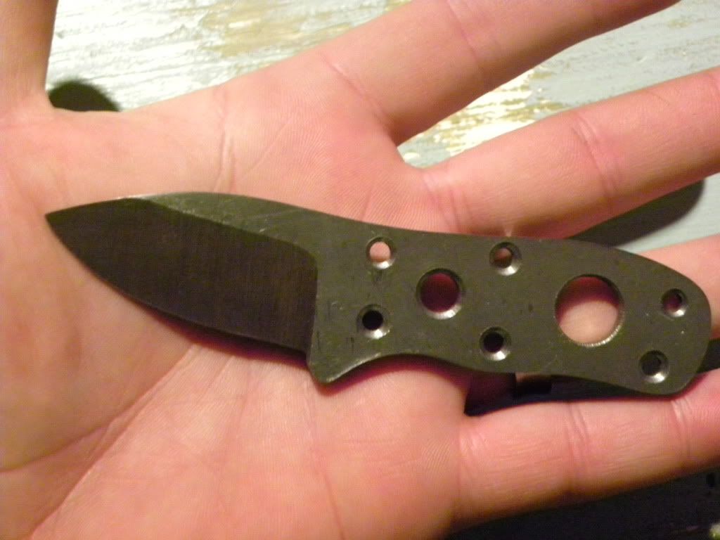

Here's an updated picture with holes in the handle. It is shown in 3/32 but I actually think 1/8 might be better because it has a high enough grind to accommodate it. Edge length is 1.5" by the way.
I also took some pics of a 'prototype' if you can call it that. :D I have medium hands and can fit 3 fingers fairly easily on it.
I just voted for number one and seeing the pic ol_sc posted makes me happy that was my choice. Looks like a good grip and some protection for your index finger. I like the other two designs quite a bit too, but it looks like it would be pretty easy to accidentally cut your index finger when using them. Maybe if they had some sort of a small guard?
